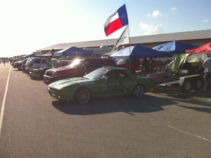

Ha, that's way funny that we have the same number, we had a different number in April but for whatever reason they assigned us another one for the race a couple of weekends ago. That picture is from two weekends ago in Houston at the YeeHaw It's Texas event. We won't have the car back together for November, as I'm in school and don't have a ton of time to fix what needs to be gone through. Hoping to hit 5 or 6 races next year, though.

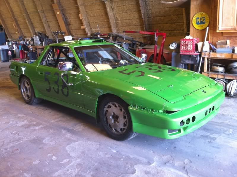

Life and other such obligations got in the way of progresss for quite a while but we're back at it for the coming season and making decent progress.
The cage is in and done, the aluminum bent for the dash, the seat base made and the seat fitted for the drivers. I'm working on the motor now. The car as I bought it was a basket case as it had a blown head gasket and the previous owner had pulled the head on the car. I finished pulling the short block down today and the block and crank look very good. Standard size cylinder bores and the rod journals turned .25 with the mains .5. Both sets of journals look nearly perfect so a light polish is all that's in order there.
Pictures of the cage:
These were, of course, pre-weld and things are just held into place with tack welds and clamps and such at this point.
Here are some post weld pictures:
Front down tube floor mount-
We tried to weld the windshield bar to the firewall but the metal there was doubled, with a gap, and very thin. instead we drilled and through bolted it with a plate on the engine side. It took a crappy picture though-
Another crappy picture, but gives you an idea of the dash we're running.
Steering wheel will be a modification to allow a quick release setup at a reasonable cost.
We're runningn a Kirkey race seat on a custom floor mount that is fixed. We debated putting it on sliders but opted instead to set the seat up for the driver with the longest legs and use resin/beads to take up the space for the shorter drivers.
The engine will be basically stock. The only thing I'll probably do is put a manual boost control on so that if we need it at the end of the race we can bump up the boost a few pounds. I think I'll mount that out of the reach of the drivers though so they don't get HP happy and blow it up. :)
The car chassis is currently in getting paint squirted on it. The interior is going to be done in white, the exterior in whatever my team mate/body shop owner decides to do. We'll find out when he's done. :)
