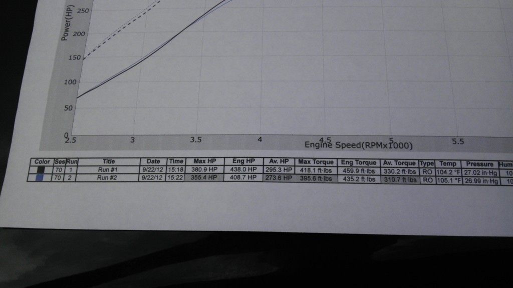

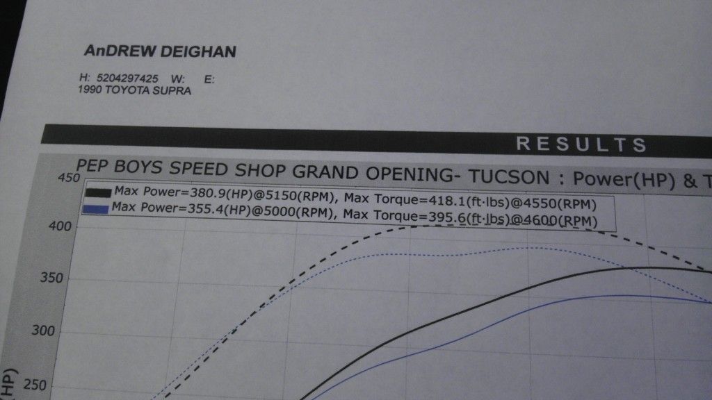

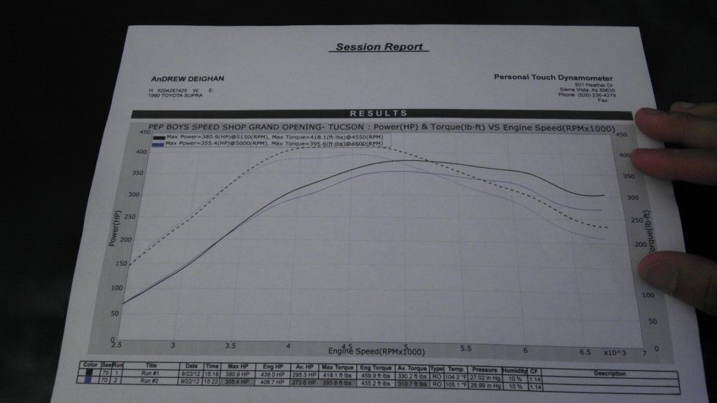

So today we had a dyno day in town decided to throw up some of our local supra's on it
Dyno was a Dynamometer we were told it runs a lot like a mustang dyno
Black Supra did 380whp and 418trq stock twins on 18psi

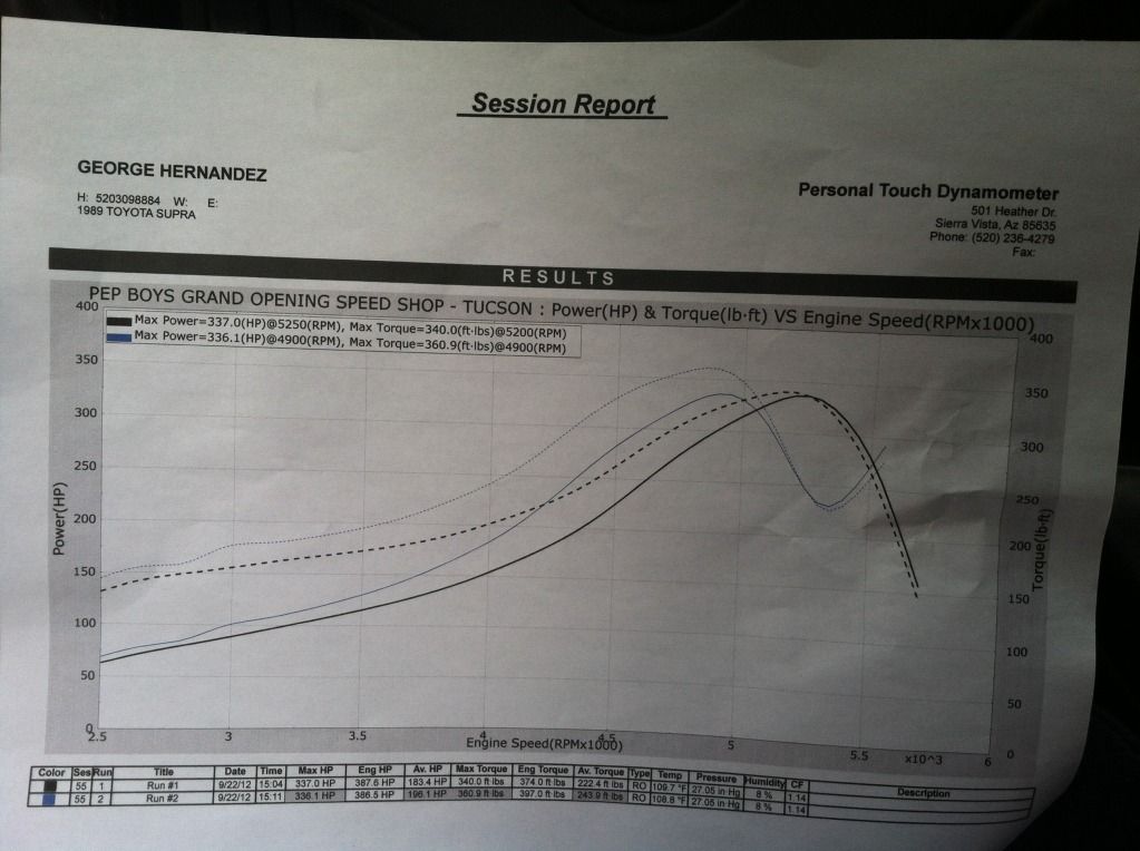

White Supra did 336whp and 360trq T4 60-1 on 16psi with bad fuel breakup

Mods
Intercooler 2.5 inch pipe tial q sport bov
2j map sensor
3inch turbo back
Aeromotive afpr
Walbro 255lb
Wideband
Safc2 and mines ecu tuned to 11.4-11.7 @ 18psi
3inch intake pipe and filter
Bk7re plugs
No ac or ps
Aluminum rad
1 16in electric fan
Act stage 3 6 puck sprung disc

You guys have to Remember the dyno was outside, when I did the pulls on dans car (white) it was about 109 degrees out with no fans. These cars could possibly make more in cooler conditions.
Plus you forgot to mention Andrew is one stock 370cc injectors.

I'm curious about the black car, his peak number seemed to come in at a very low rpm. Does give credit to my theory that the stock twins choke the crap out of these motors around 5k... Otherwise, nice numbers. :)

Agreed. we had no idea of the power it was lying down and i personally didn't even know it was possible for the twins to lay down power like that. His next mod will be 440's
The dyno did seem to read on the low side for most cars.
one example a 2013 370Z nismo put down 290whp had 4,000miles
87supraguy;1876917 said:
That was Jordan's tune not sure what the duty cycle is set to on the injectors.
I can not tune the duty cycle of the injectors with just a SAFC2
I believe you are 100% correct Brad

Another thing that makes me wonder, my car made its peak power at redline. This was with the stock twins, but only at 12ish psi. Kinda makes me wonder then, with higher pressure, if the power would peak out sooner. I'm running a boost controller now, and it hits about a 17psi spike before leveling out to 15psi...

Also could be to the aggressive tune of the mines ecu
