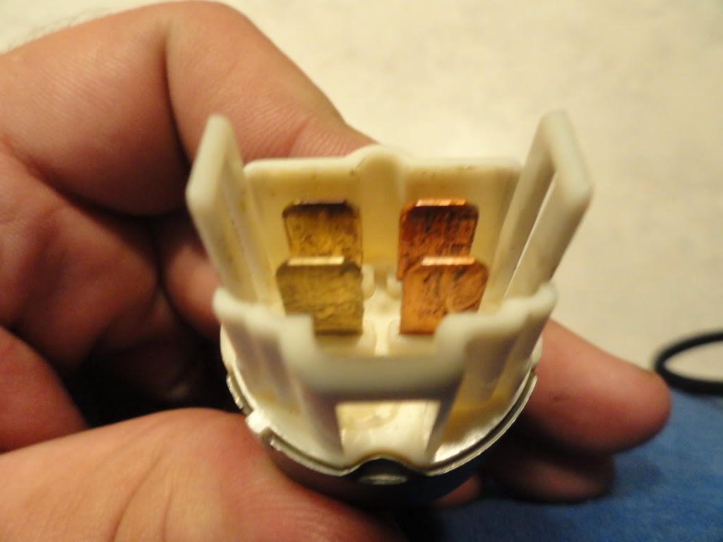

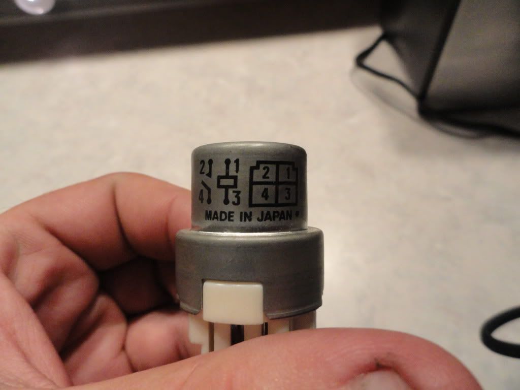

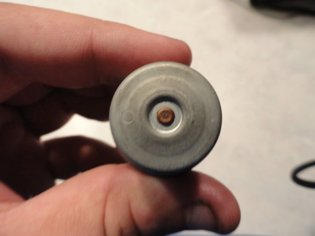

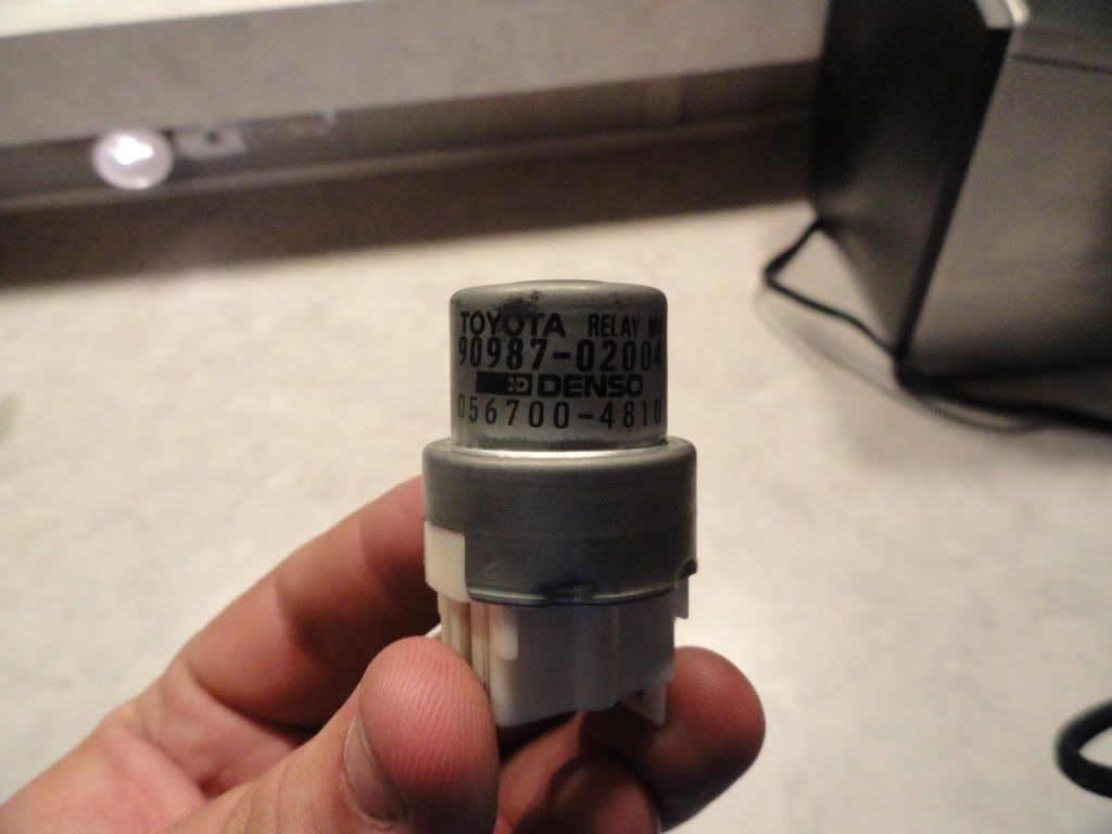

Well the car will not start. it will crank over but nothing, i know the fuel pump is not turning on. and my wideband and safc will not turn on either they are wired into the wires going into the ecu.
My first thoughts were either my ecu went bad or my main fuse went. ive opened up my ecu and dont see anything burned or any traces or anything but i dont know how to test my main fuse. i took some pics dont know if you can tell from the outside of it i wouldnt think so though.
