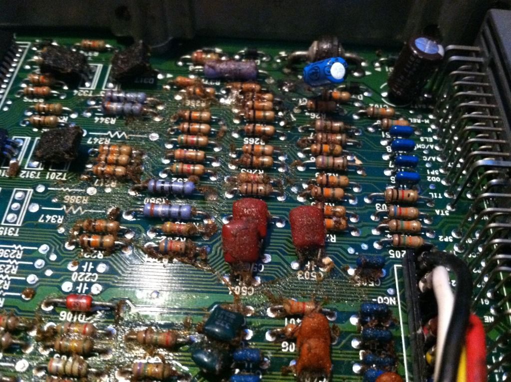

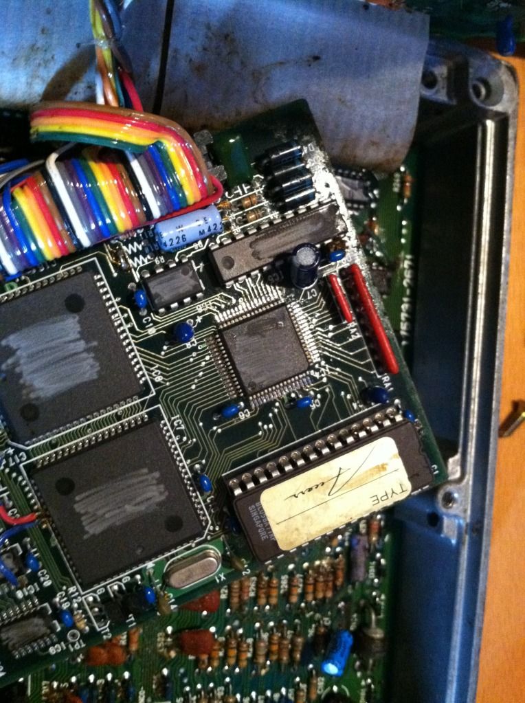

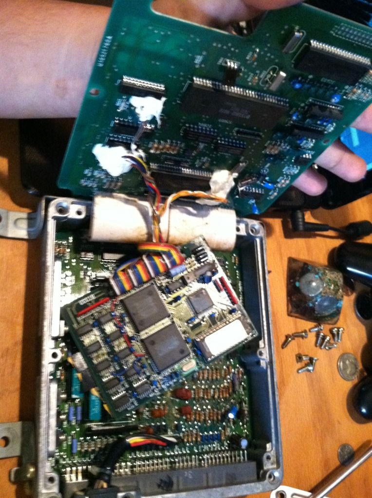

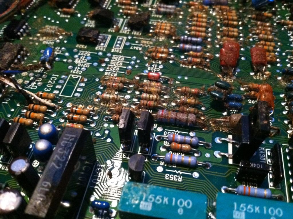

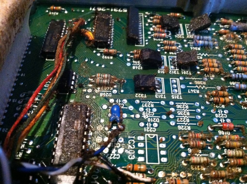

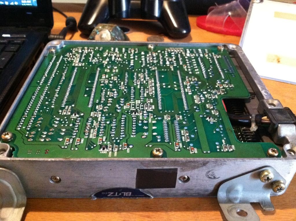

opened the ECU this morning and can't tell if it's leaking caps or something Blitz prayed or coated the ECU when they were in here last cause it is everywhere!!!!
looks good so far
then i see all this crap literally everywhere
BAD ECU OR SOME SORT OF COATING FROM BLITZ?
