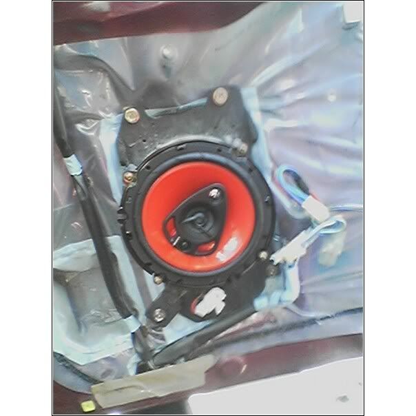

91-92 cups w/ 6" speakers look like this from mine:

With the stock speaker cups in the pre-91's I don't think you'll even fit your door panel on. Just make your own if your low on funds. Use the search button I know the thread exists but I lost all my bookmarks.
91-92 speaker cups go for about $100 in the FS section... but you really got to keep your eye out for a 91-92 part out since they are pretty rare.
