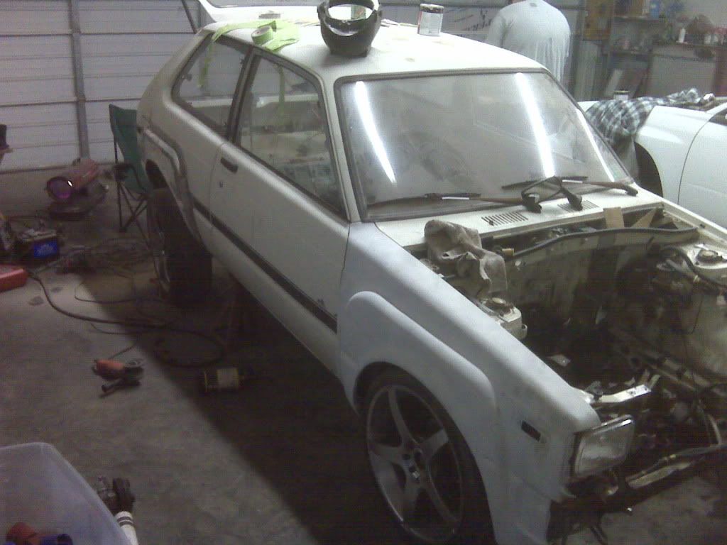

It was been an ongoing project for about the last month and I hope to have it done this summer. I made a set of steel wide fenders out of the original fenders and still have to do the back. I will driving this car on the street so I need a wheel size that will not only hook to the road but also facilitate big brakes. These are not the wheels Im running but are just for visual reference.
I have recessed the firewall 4 inches to keep a proper weight balance and radiator clearance. Here are a few pics to get started. I will update the thread as progress occurs. Thanks for looking.

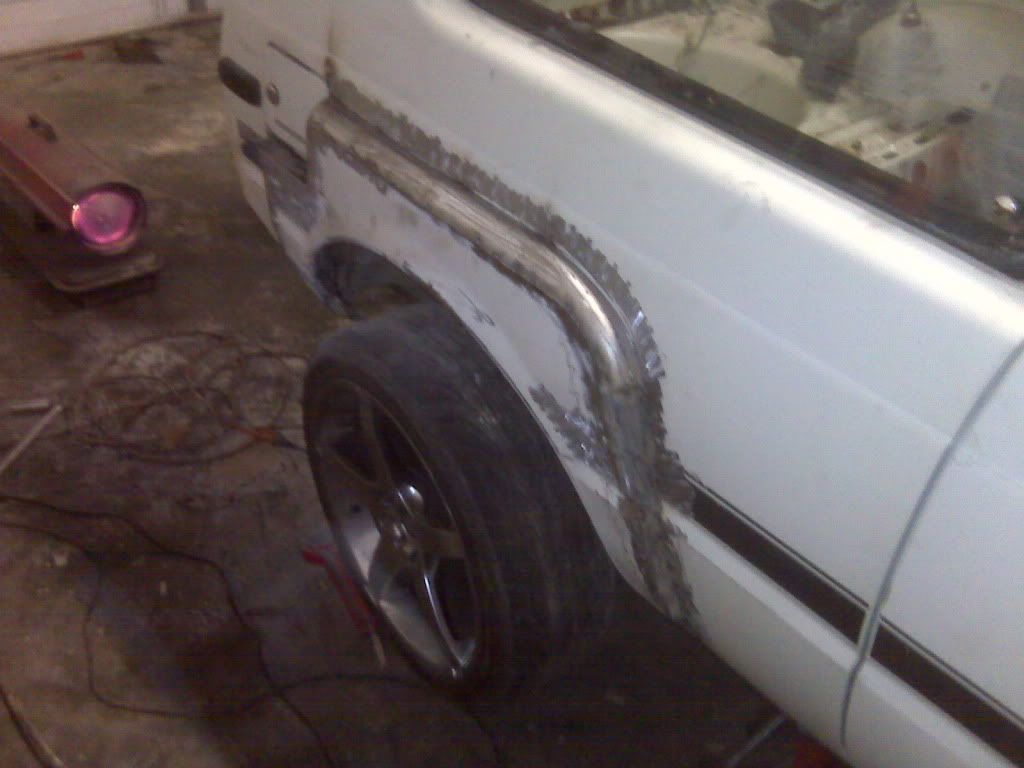

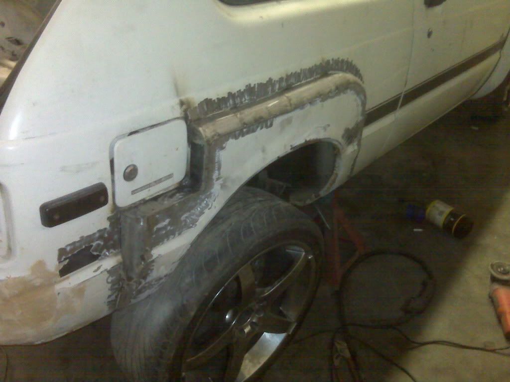

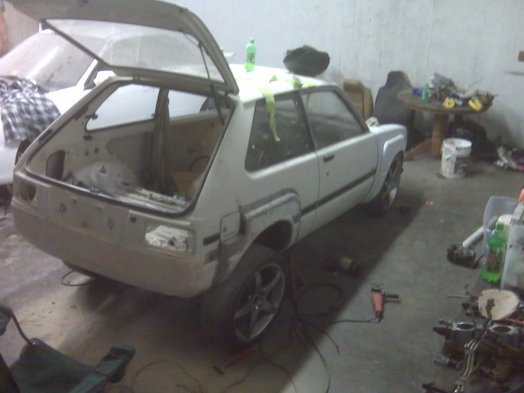

Ok so I started on the rear quarters to widen them to fit the 10 inch wide wheels. I need some input. Should I carry the shape over the gas door and suicide it or just leave it recessed like other widebodies do? Anyway let me know what you think. Here are some pics of it all tacked together.

I'd never have thought in a million years I'd be "Subscribing" to a build thread on a 1981 Starlet......... Guess there's a first for everything. ;)
I look forward to seeing where this build goes.
I started off in the auto world as a body man, so I'm loving the "widebody" work so far.
Although I think extending the body to the gas door would look better,
Once you've got it all together, squatted, and sprayed, it will look great as it is.
