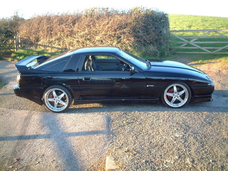

19s fit no trouble. i am on cusco adjustable coilovers lowered at least 30mm
I have 19/8.5 on the front and 19/10 in the back. Offset is 38 on the front and 35 on the back. Can't go any wider than 265/30 though as i think it will rub the arch.
