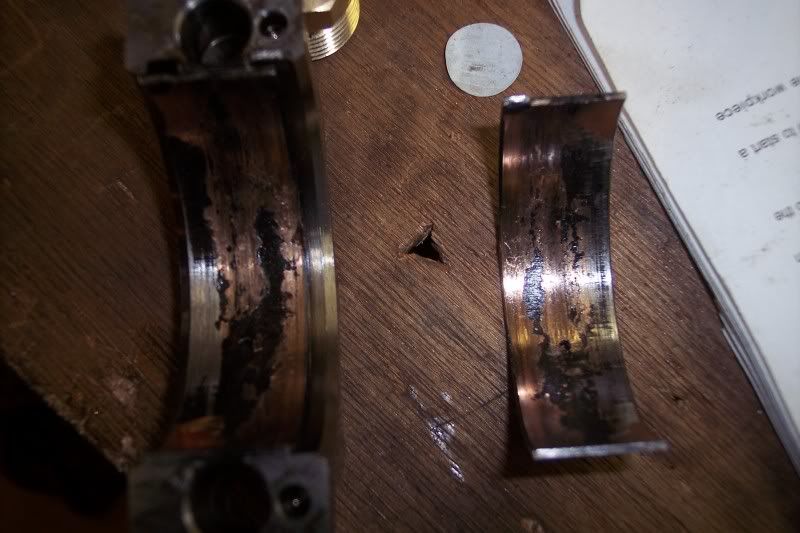

Maybe it was just a coincidence but after reading the oil info article I changed my perfectly running GTE to 0-40 mobil 1 ( the only 0- oil I could find locally) and the car spun a rod bearing withing 100 miles with the oil pressure never dropping from normal. Before the change pressure was a bit less than I like in other engines, but always more than 10 psi per 1000 rpm. With a mechanical gauge I was getting about 10 at idle full hot, 20 to 25 slow cruse and 40 to 45 at 65 mph in 5th. Pressure never dropped, but fatal pecking noise quickly became loud rod knock and I shut her down. Any chance a worn engine did not like the 0 weight?

I dont see how it could cause a rod knock, it must have been coincidence unless it was a defective batch which is highly unlikely (just cant say impossible)
I have run that oil in my 7m, and im sure MANY others have without any effects.

It was not the oil - that includes Mobil 1. What were you doing with the car after the oil change before the knock occurred? Any rapid accel/decel? High G turns? Did this motor have a HG failure in it's history, especially recent?

Jdub says the 7MGTE was designed to use oil in the 10-12cSt range @ 100C. Mobil 1 0w40 is 14.3cSt @ 100C. Which is too thick for a stock 7MGTE. It is also thicker than most 5w30's when cold @ 80cST @ 40C. That is just more unnecessary wear. That's what happens when you "feel" that one oil is better for your engine than another. I base my oil decision on facts.

Those bearings do look like a supply problem. Concerning the other guys blaming the oil, you'll meed to say what else has happened to the engine or under what conditions the knock occurred.
