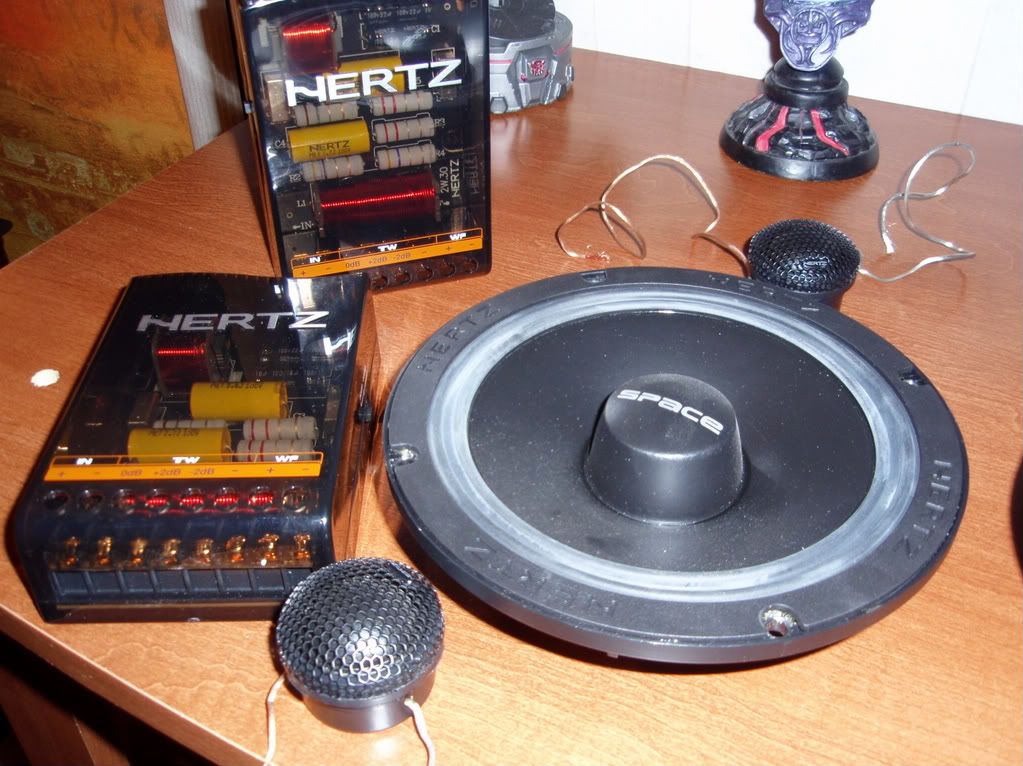

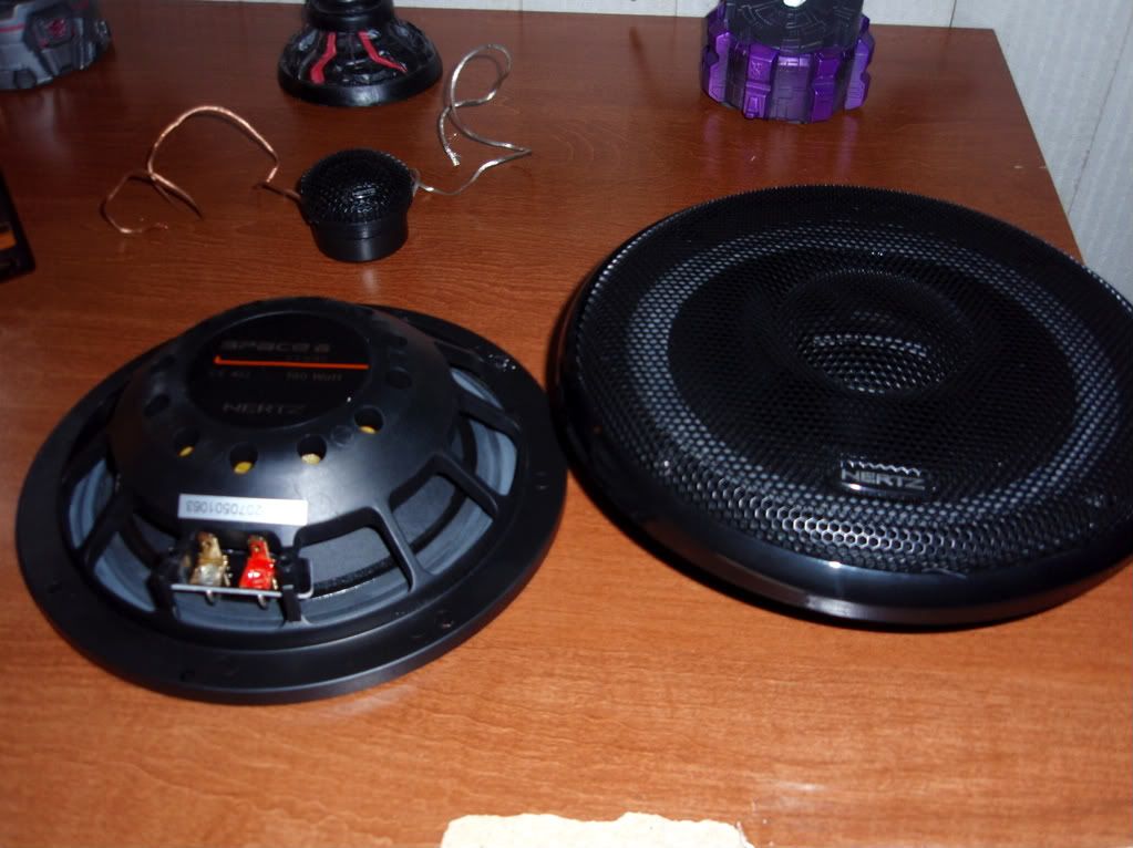

i made my own brackets but i am sure these will fit
they are hertz space very nice clear sound
Description:
"Hertz has solved one of the biggest problems in car audio: how to get effective bass in cars whose slim doors can't accommodate the depth of a traditional woofer chassis. Thanks to its exceptionally strong, multiple-neodymium magnet, and a highly innovative design, the aptly-named Space both keeps an ultra-low-profile and delivers astonishingly clean, powerful low frequencies. The k6l is a superb all-round two-way system, comprising a flat woofer cone, a one-inch Tetolon fibre dome tweeter and an optimised passive crossover"
