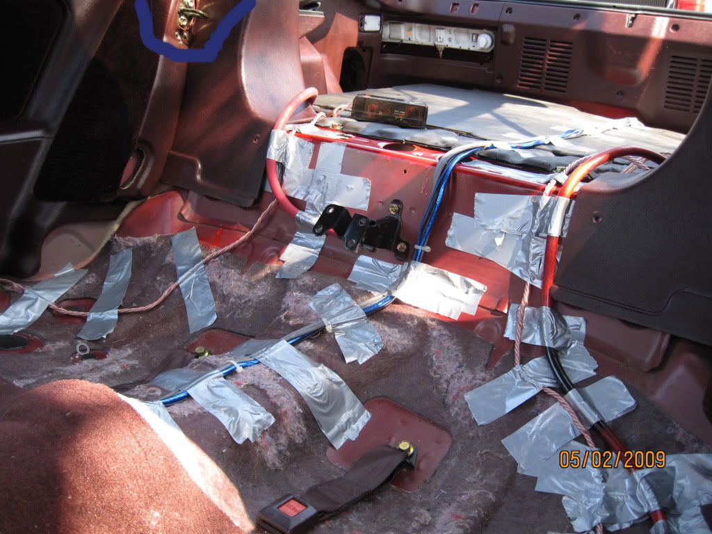

I was wondering were yall ground your amps at...
I chose to ground it with a screw where the targa top goes but i keep running into issues every month or so and im tired of going back there to jiggle it...
any suggestions....

i grounded mine to the battery, which happens to be located in the trunk. But i also ran a ground to the rear seatbelt bolt after cleaning the paint off the surface.

i grounded mine to the rear seat bracket

wherever you ground it, make sure to have a firm connection, and to use the same gauge wiring for the ground that you have going into the amp

The cross member at the rear seat is a great place to ground. Its thick metal and is in the center of the vehicle. Avoid using any pre existing bolts, always make a seperat ground on bare metal if you can. And use multiple screws if you must to make a good connection.
