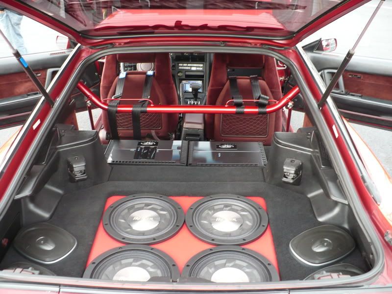

s0ulstar;1029167 said:
have you looked at the shallow mount subwoofers? i was looking into these.
http://www.crutchfield.com/App/Prod...&c=3&tp=111&nvpair=AG_General|FFShallow_Mount
ive got four pioneer premeir shallow mounts in my trunk minus the spare but i can still use my targa... if you do like 1 or 2 12's they hit great and the way they are made with an air suspension sytem and the hit all the frequencys... like i listen to rock, rap, hip hop, jazz, ska every really and they hit everything very nicely. with only doing one or two you can still have access to your spare and still use your targa top. here is mine so you can get an idea. i love them they sound great.
