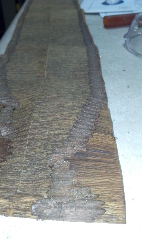

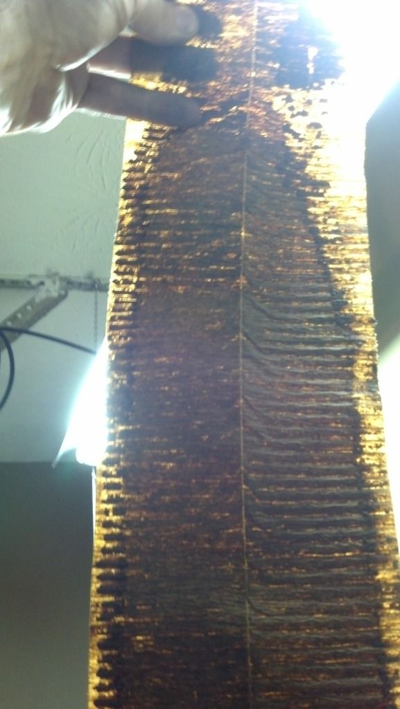

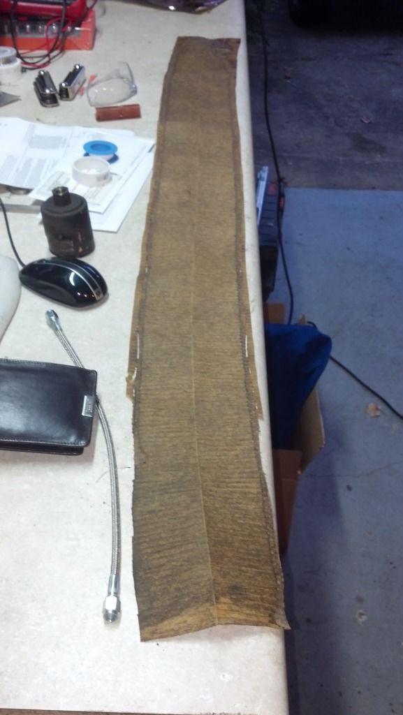

supraguy@aol
Well-Known Member
Dec 30, 2005
4,270
64
Atlanta
My filter element.
Normally, its folded in half along it's length, then rolled up.
This filter had 190,000 miles.
The opaque section is solid dirt.
