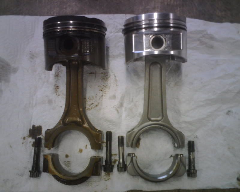

I got JE pistons and Manley rods. I was happy with both purchases from the respective companies (I GOT STICKERS!) Here's a nice pic of my 2J's OEM set beside the new JE-Manley set up. Manleys are a bit cheaper as not as well known.
