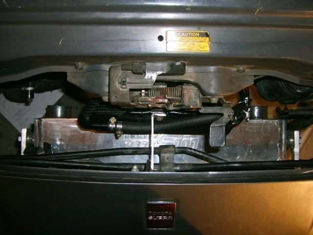

The think is that I wanted my monster IC to have lots of ground clearance.
And lower part is a bit tilted to the back.
The B&M cooler is the largest incl fittings making the cooler 2" higher.
Got creative and made up one out of cardboard to really make sure what was possible to fit.
AC stays and rerouting or bending the alu pipes is not happening.
Thanx for your replies.
Here is a pic of my setup so far.
suprafredde
