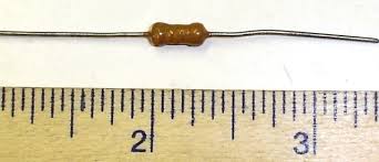

Getting a resistor that matches the Resistance specified but has a larger wattage rating will not hurt you. The wattage is simply the amount of power tha resistor can handle as a normal load. A 1/8 Watt resistor wouldn't handle the power a 5 Watt resist could. A 5 Watt resistor is overkill IMO, even though I'm not familiar with the system. Just make sure it's 10 Ohms and you should be alright, a higher wattage/power handling capacity would be better than a lower one though.
See the difference below:
10 Ohm 1/2Watt
images
10 Ohm 5 Watt - See how it's much larger? (overkill)
images

p= u2 /r , so if there is 5V (i'm not saying that it is just IF), in 10ohm it will be 2.5W
I=u/r , again IF 5V ,it'll be 0.5A, that seems like pretty high numbers for a sensor hehe..
Are you sure you dont mean 10k ?
Also found this..
http://www.cygnusx1.net/Supra/Library/TSRM/MK3/manual.aspx?S=FI&P=96
seems tha only really need 10k to be "in range" (If it's not drawing current from another source)...
Of course it can hurt, I'd rather burn a 1/8 watt resistor if a 1/8 resistor is all that is needed, than an expensive piece of electronics.. otherwise, measure voltage and follow ohm's law..
