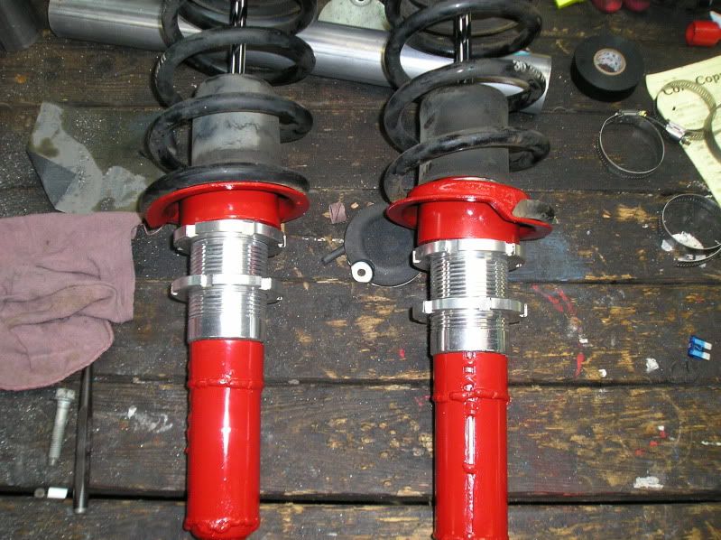

After spending quite a awhile searching both here and on SF, I can't quite seem to find the answer I'm looking for. The gixxer_drew thread was a very informative read and I recommend it to anyone looking to build a custom coilover setup, however it lacks information specific to MK3 fitment.
I'm basically looking to build a coilover setup using sleeves and 2.5" springs fitted to Koni 8040 series shocks. I'm leaning towards 650f/350r springs or maybe even 700f/400r. My issue is determining which spring lengths to order.
Has anyone built a similar setup that I can use as a guide? The gixxer_drew thread mentions the use of either 8" springs front and rear with helper springs in back or a 10" spring in the back for softer springs. My supra is under a ton of snow right now so I can't exactly go out and measure free lengths of the stock setup.
Aswell, what options are there for the upper mounts in the front? I've seen them used as is but with a significant reduction in available stroke. I don't want to go pillow balls unless absolutely necessary....can the stock upper mounts be modified?
