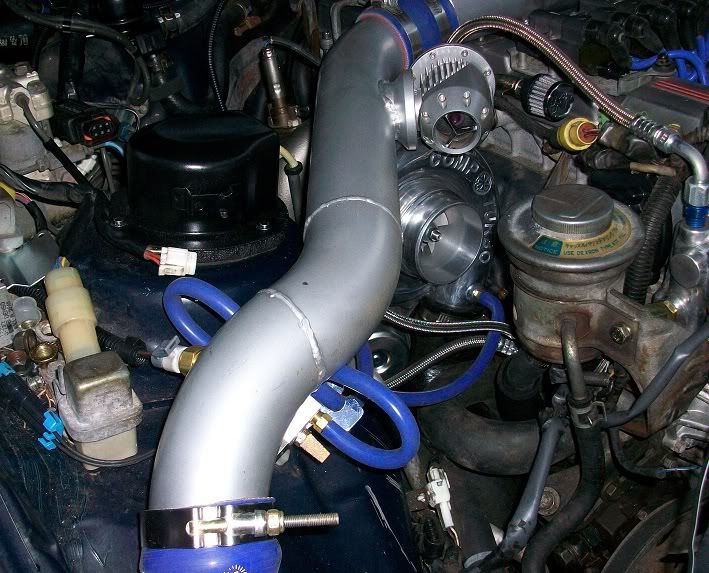

Hey guys, I am trying to find info on map ecu1 for my 7mgte... I'm installing it and have a few questions! Please help me if you can.
#1) Where did you mount your inlet air temp sensor? I was thinking about installing mine in the 3000 pipe.
#2) What did you do with your factory/lexus AFM? If map ecu deletes it what do I put there? I have a lex afm and an apexi cone filter. Anyone wanna show me a pic of your setup or detailed suggestions?

Dont install it in the 3000 pipe. I installed mine in the IC pipe as it came out of the fender. See the pic.
Placing it in the 3000 pipe over the engine will give you a higher temp reading. That why most suggest to install in away from engine heat.
