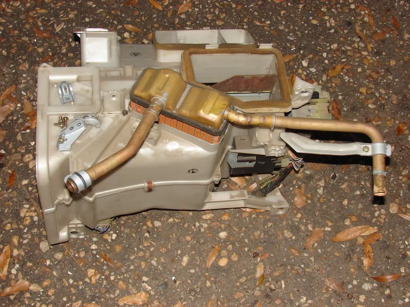

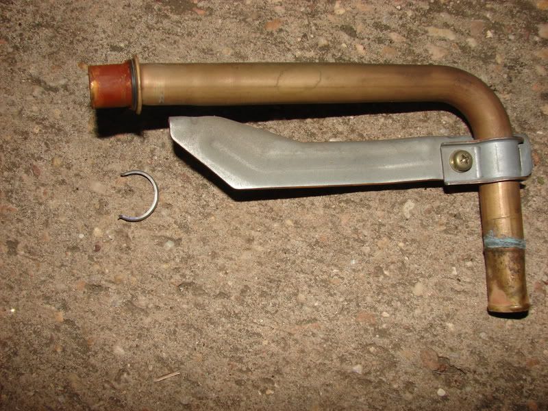

You need this:
It comes from here:
And just comes apart by removing the clip seen in the first pic. It is not part of the heater core, but is clipped on to it. Removing the heater core housing is not an easy task without first removing the dash. Even then, it is somewhat difficult to remove. I just bypassed mine, but it never really gets that cold where I live, and I drive only a mile to work.
