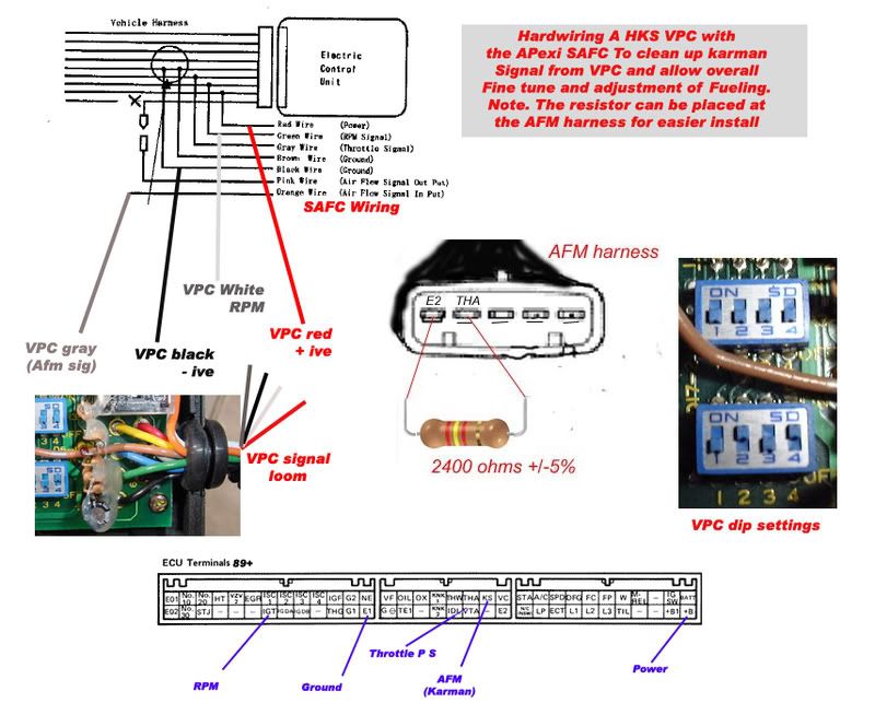

Picked up a used vpc to install and wanted to make sure it is operable prior to installing in the car.
Should it power on with just the red to 12v+ and black to ground (both in the 9 pin connector)?
