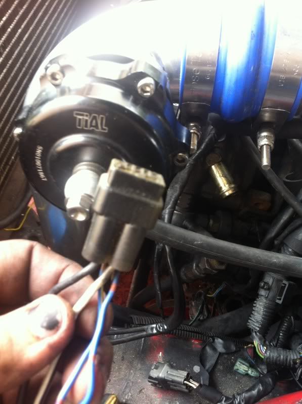

So I was working on moving my fusebox around in my bay, just swinging it over to where my battery was and I unplugged a couple of clips, now I have one that I cant seem to find where it goes... I tried looking on the tsrm with no luck.
It's a plug that comes from the loom that goes to the fusebox, it's a 5 pin connector with 4 wires going to it, b-y, black, b, w-b.
Please help!!!!

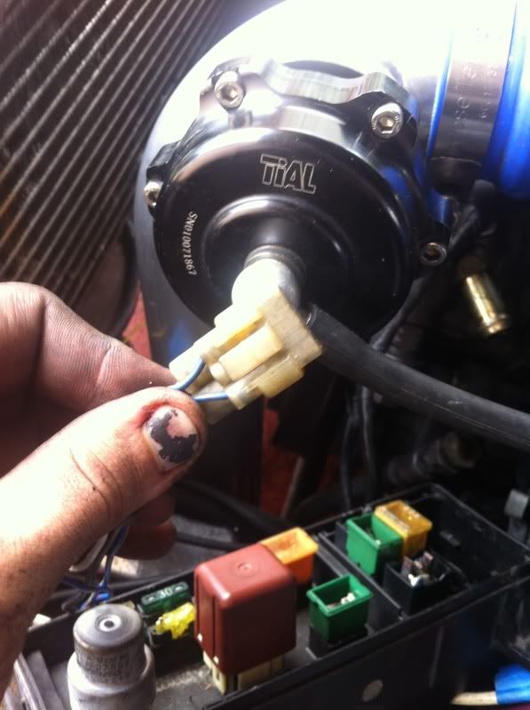

It's not the c1 plug, it's a white connector the c1 is grey and yes it is 3 small two large.. I was under the impression that it might not connect to anything since I looked all over and couldn't find any other plug to hook it up to...

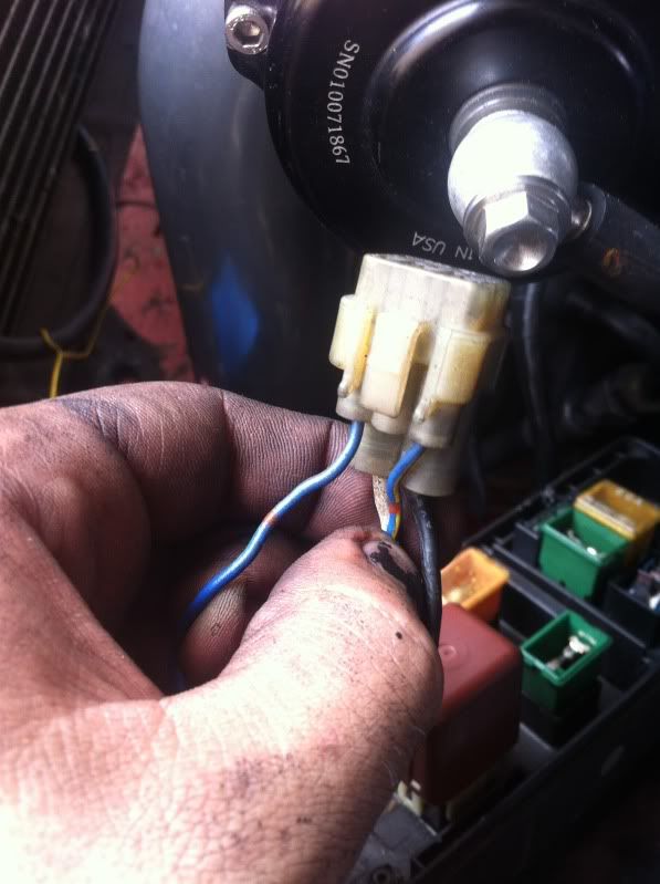

i hope you guys enjoy the paing on my nails =) lol was pointing some interior plastics lol
Here is the plug... It is in the loom where the fusebox is, thanks for everyones help!

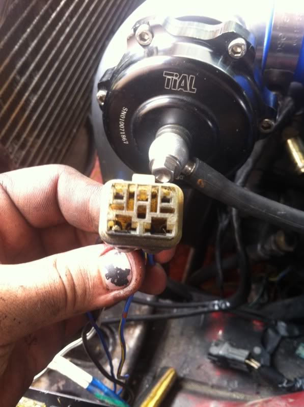

ANSWER: Headlight Cleaner Relay. Info below. Looks like it plugs into the relay mounted near the fusebox.
Wiring manuals rock. I suggest everyone familiarize themselves with one, haha.

ahhh there it is, i tried looking in the tsrm and got to that same place but i guess i overlooked plug b, thanks a million suprarx7nut your my hero! (non gay voice of course) lol
