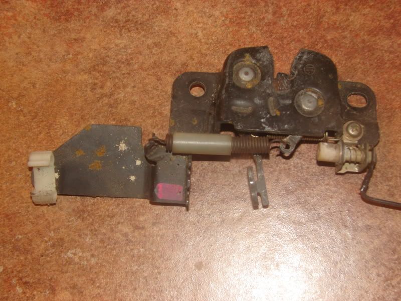

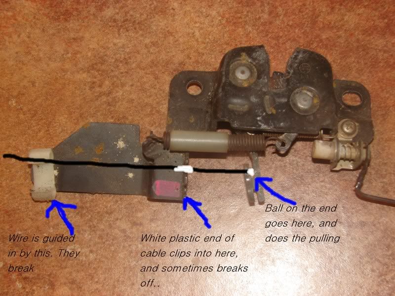

So my hatch release has not been working and finally Matt and myself decided to try and finally fix it and also put on some new parts too
Anyway, after we got the panels off and tried to remove all the slack from the cable, it still does not work. So we dicided to try to take the center lens section out because the cables run behind it, but 2 bolts won't seem to give.....the bolts themselves are not stripped, they just turn and turn without coming out......and if we really yank on it, i'm afraid we'll crack it. :cry: I already have to buy a rear driver's side lens, and hopefully I won't have to buy a center section also. :aigo:
Anyone have any suggestions for further troubleshoot the hatch release.
