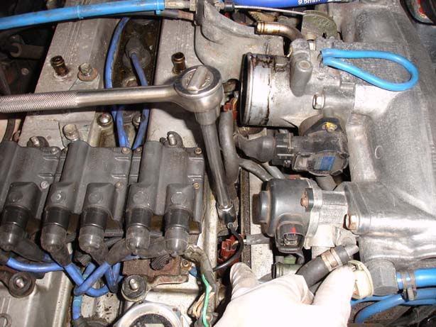

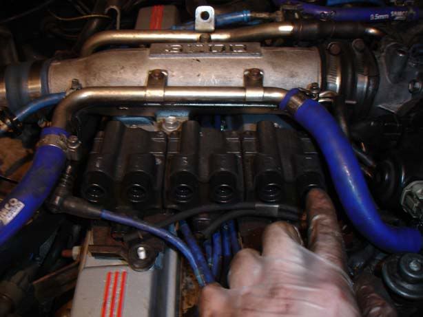

Step 2 - Undo the four 10mm nuts that hold the coil pack in place
Step 3 - There is a black wire that runs from a screw on the coil pack to a bolt which provides a ground connection. It is easier to access the bolt than the screw so remove this (12mm)

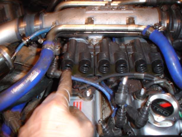

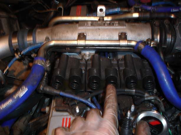

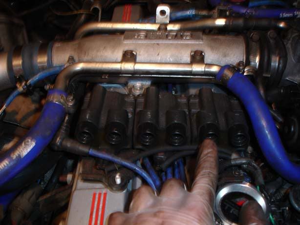

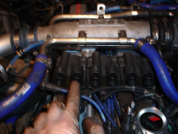

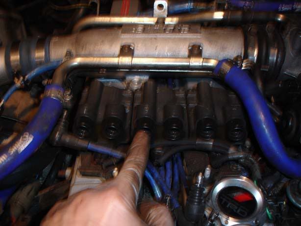

Step 4 - In case you get any problems here is the coil pack order (Firing order is 153624 coil order is 163425), this series of pictures shows me pointing to the HT lead for each cylinder, so picture 1 is cylinder 1 etc
Remove all the HT leads from the coil pack

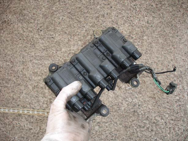

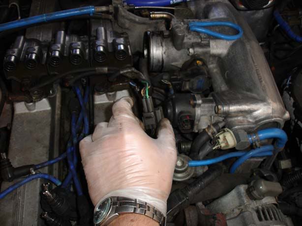

Step 5 - Remove the connector to the coil pack
Step 6 - The coil pack should noe be free to remove from the car. Lift it up over the mounting screws and it should come away cleanly
