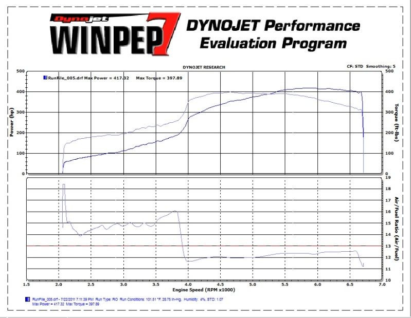

I had a stock aristo 2j on stock ecu with map ecu piggy back with a divided .70AR 67mm journal bearing and saw full boost (20psi) at 3700-3800rpm here is the dyno graph

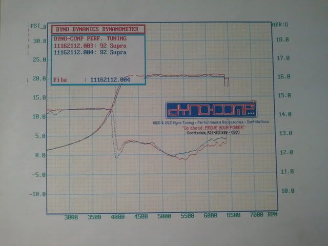

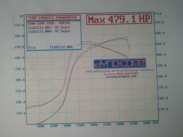

Then I put in 264 cams, and went to a undivided .81AR ball bearing precision 67mm and I get full boost 4200 rpm, here is the dyno (currently looking for a divided housing and going standalone so with e85 so I plan to gain back atleast 500rpm of spool.)
