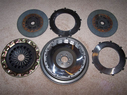

OS Giken twin disc clutch show 2 sprung discs, as seen here
maybe its just the setup spec uses that they cant use both, unless 1 disc engages first (the sprung disc), then the 2nd (un sprung) to provide the extra clamping power, but yes both being sprung would be good to reduce shock loads.

IIRC, the spec discs are thicker, so they probably can't fit two sprung discs in. Also, there are a fair number of folks pushing similar power levels through a tilton triple, which is also entirely unsprung as I recall.
