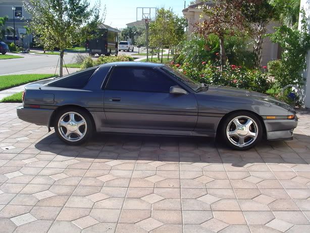

Looking for an idea of what Ford FR500 wheels would look like on my Supra...
Best side pic of a car with the wheels I want...
My car...
Any help is appreciated!!:icon_bigg

LOL, yeah it was, but I dunno how well they would fit in regards to rubbing.
18x9 +24 offset 5.85 bs
18x10 +22 offcet 6.38 bs
Was thinking of doing a 295 tire out back 255 up front....I guess with the fenders it should be ok, right?

Yep should be fine.
I'd go with 285 tire personally.
I've read that anything much over 275 isn't providing anymore help to you other than just looks-wise and I think the 285 would look slightly better anyways on a 10" wheel, even 275 like I currently have on mine.

With those offsets you are pushing it.. They will be sticking out a lot in the rear and a tad in the front with my calculations.

OK, what about if I did a 17" setup?
17x10.5 +28
Will the extra .5 in wheel width make it stick out the same?
Ninja edit: What if I got some of the overfenders you posted up a while back?
