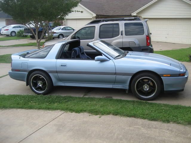

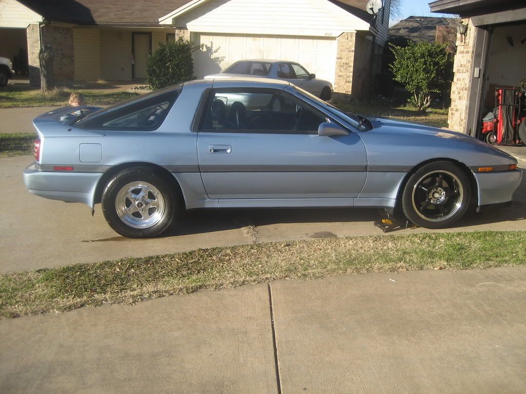

Here is what the car looks like, note the jack stand is there because I didn't want the car rolling back on me when putting on the DR's.
Before Bilsteins:
After Bilsteins:
