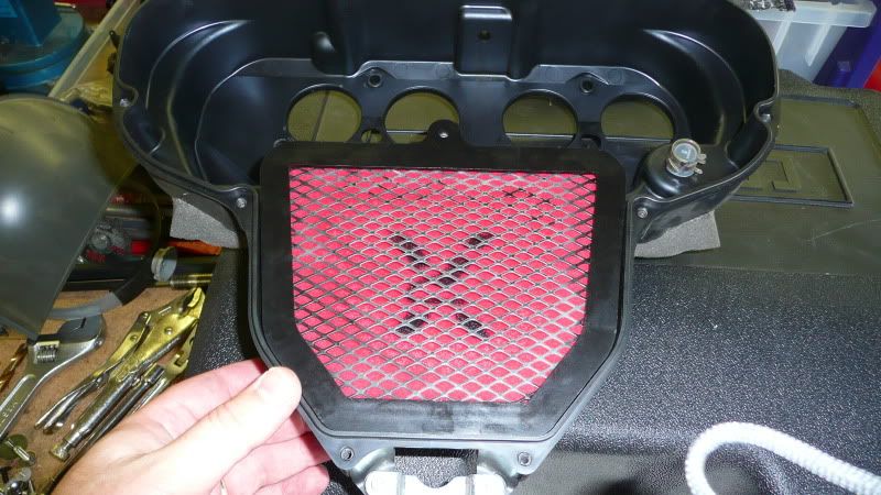

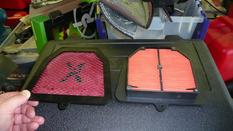

I just put a Pipercross filter on my bike.

What many people forget is that all oiled filters are depth filters v/s just holes in paper or mesh screens.
Once the holes are plugged up, the filter flow drops, where depth filters just keep on working fine, and many claim they even become more effective at trapping smaller stuff as they build up a coating of dirt/debris that in turn is coated with oil, and actually creates more surface area to trap stuff.
The reason I went with the Pipercross v/s K&N on my bike was the dirt bike filters work great. And this is basicly the same idea, only for the street.
