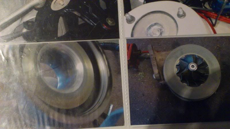

I have a ct26 that is fitted with a to4 centre and has a to4 p trim turbine in the ct26 rear housing and in the front housing it has a T04B Super V Trim Comp wheel, does anyone have any idea what sort of performance I could expect from this turbo and how many rpm it going to take to bring it on boost?

The rear wheel is 2.881 and 2.515 as best I can tell I will try and get the front wheel in a few minutes, I got to pick the kids up from school.
ok front wheel is 2.755 and 2.17
If I have measured them correctly

I remember this "upgrade" being kicked around years ago and some people used them. The main issue is the compressor housing is too small causing true compressor surge and causing issues (snapped shafts). As the wheels don't look THAT big on this particular one, it might be fine. Keep in mind the stock CT shaft is actually beefier than a normal garrett...
