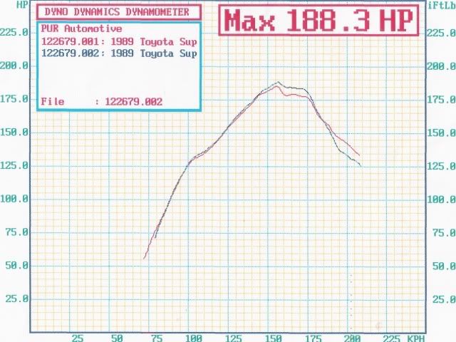

Finally got to the Dyno after the exhaust upgrade.
Different Dyno. This was done on a Dyno Dynamics machine. Ambient temp was around 18C.
First run: 185.4HP
Second run: 188.3HP
http://www.youtube.com/watch?v=ip9kO7bfAvQ

Hey Ron. Which parts were installed on the car. The dyno seems kinda low and I'm not sure why. Your stock dyno seemed to be in line with the standard. To only pick up 10 hp from a full exhaust and DDP is not.
Full exhaust. From DDP to muffler. 3" all the way. Keep in mind this is on a Dyno Dynamics and apparently they are more accurate. My 1st dyno session was on a Dynojet. I was told you will get higher numbers on those. Anyhow, I think my engine is tired. Cranking up the boost will definitely give me more, but I think I need to refresh my engine!
