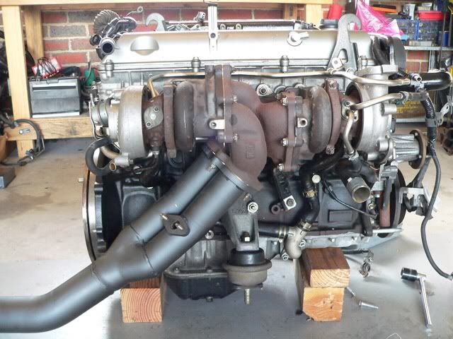

For clarification this is what ill be doing to a customers car:
Take a pair of JDM CT20 2jzgte twins,
#1:Replace the ceramic turbine blade with a higher flowing steel/inconel turbine
#2: Machining the Compressor housing to fit a GT2860 disco potato compressor wheel
#3: Machine open the wasgate ports to a 34mm
#4 Machine a sleeve for the rear turbo, and convert it to internally gated control
#5: Get rid of all the B/S sequential in the exhaust and charge piping
#6: Run in full true parallel
Just nee a custom Downpipe and spacer/modify what ever need to be modified.
similar to this:
