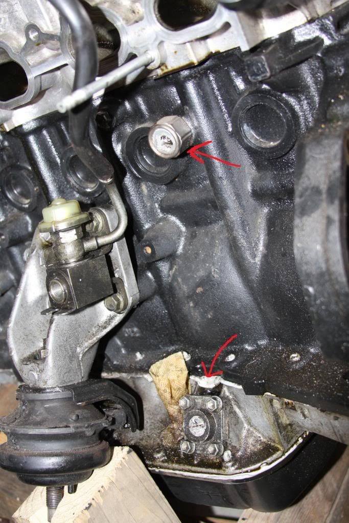

    Default Re: 1JZ rebuild time! Questions->recommendations needed!
    Question. I was dissasembling the motor the other day, and found 2 broken sensors on the block. One actually in the pan right next to the dipstick port, and the other near the top of the block under the intake. I have a pic. Please help me identify the sensors, and maybe give some insight where i can find replacements... Thank guys!

    The top looks like the knock sensor ,the bottom is the oil level sensor.Should be the same sensors as the 2jz ,you can get them at toyota.or post in the wtb section.

    you dont need the one at the bottom iirc. no gauge on our dashes for it
