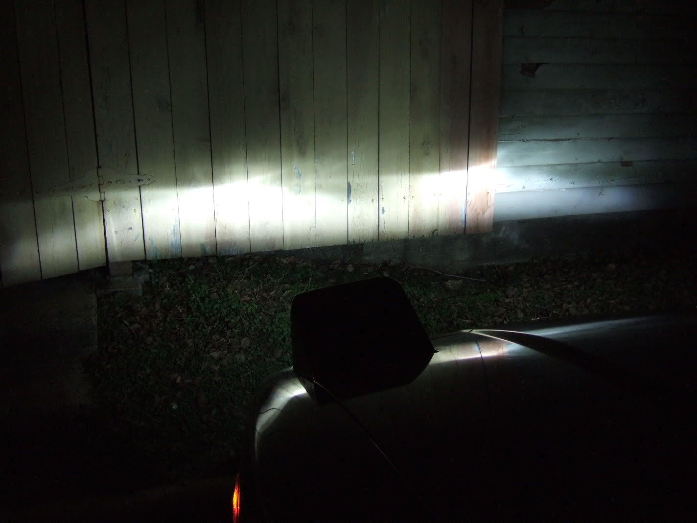

    im running 35w kit in e-codes an arizzle is right light out put is only a little bit better than good halogen bulbs. Heres a pic of my 8000K kit before i aimed them lower to show what they look like at stock height (i think mine were higher than stock but thats how i got the car *shrugs*). and 4300K or 5000K would obviously be better but i got these at a cheap price so i figured WTH ill try em out.

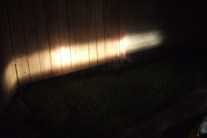

    hah. Alright. Well guys i have had a set of 8000k HID's in my headlights for about a year now. Havnt had ONE single problem with them. They are deffinately brighter than halogens as i have compared and taken pictures with various bulbs and housings. Yes, they scatter the light everywhere, but it is DEFFINATELY brighter on the road compared to any halogen bulb i have tried.
    A lot of that messed up beam pattern has to do with the way the HID lamp arcs. If you were to stare into an HID lamp that's lighted, (Don't do that, you'll likely blind yourself)- you'd see that the arc bows UPward, instead of down like a filament bulb. That alone screws with the output in a housing designed for a halogen lamp.

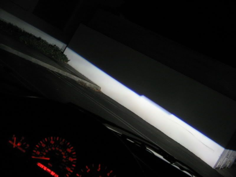

    Until you get a cutoff that looks like this:
    I don't want to hear it.

    JDMMA70, would you mind snapping a pic against a building, so we can see what the cutoff looks like?
