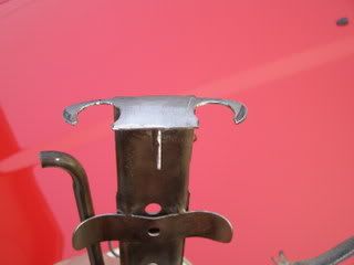

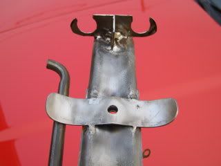

    They don't make them anymore. If you have machine shop they can work something up for you.
    Dusty at Mvpmotorsports.com sells magnetic shielding which you should use! Better safe than sorry.
    Something like this will work/ there are 2 support brackets to hold them in there(front and a back one with a screw) use stainless steel.
