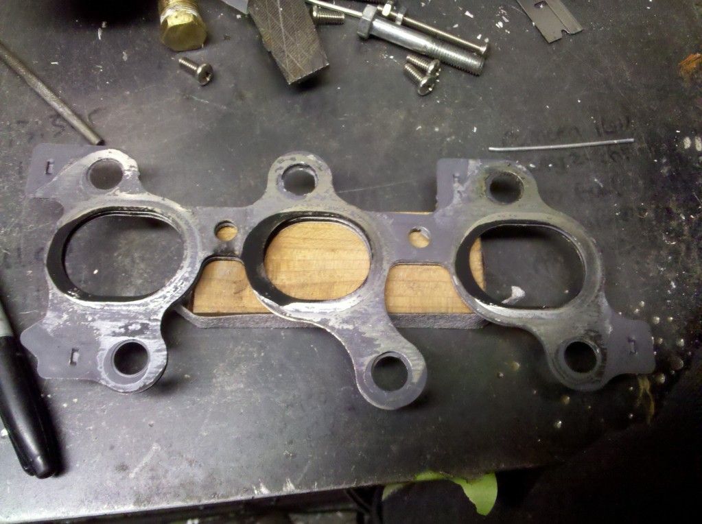

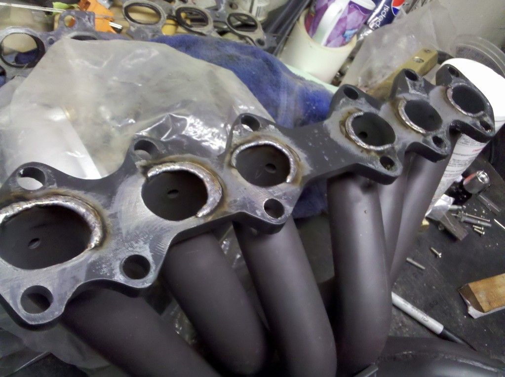

    Yep, check the gasket fitment. In the pic you can see all 6 ports are oval, and 2/5 ports are actually round on a 2j. I put mine togher and had a huge exhaust leak. Had to pull it out and weld up the port
    You can see the port mismatch from the exhaust on the gasket.

    nathaninwa, am I right when i see six EGT probe holes in that manifold?? From Factory??
    Amazed, really!
