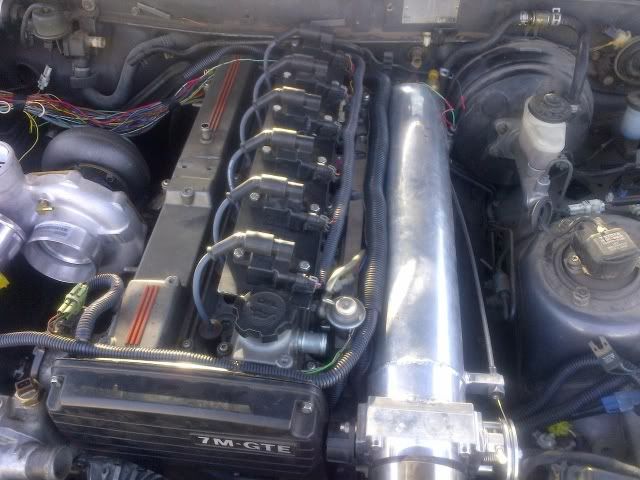

    Almost done just need get the wiring complete, mount up my exhaust which is just a 3 1/2 down pipe coming out right behind the right front tire, by thursday I'll have my throttle cable pieces that I gotta measure out and cut, make a little mount for my new coils wire them in... That's about it. I have everything but the throttle cable but the will be in soon... O almost forgot hook up my new meth kit. Believe me there is no one more stoked to see how she does then me lol I've been piecing this together for years.

    I will update as things get finished. This build has been in the works from getting the cash to slowly buying all the parts since Jan 2009 when I blew my motor so I figured go all out and never worry about it again.
    throttle cable is a go got it on this morning
    still need to complete
    -finish making brackets for LQ9 coils
    -install of NM_Motorsports SSv2 and the Marlin Crawler Shifter Socket & Urethane Shifter Bushing
    -I got wires everywhere right now under the hood cause I'm deleting a bunch of stuff out of my engine wiring harness since i'm running AEM EMS
    -the welder F'ed up my wastegate flange cause he is a incompetent douche so I had to order another one, different welder this time
    -install meth kit
    -bolt up downpipe to shorty exhaust
    once all is finished break in time for the motor since this is a fresh build
    Finished and ready
    motor spec's, 7m of course
    -Eagle Rods
    -Wiseco Pistons
    -Brian Crower Springs and Retainers
    -Ferrea Valves
    -Brian Crower Cams 272/272
    -Titan Cam Gears
    -3 angle valve job
    -arp's
    Intake and IC info
    -3 1/2" TB FFIM by Sethron
    -3 IC piping
    -Godspeed IC in/out 3"
    -4" K&N filter
    Exhaust
    -3 1/2" downpipe extended out behind the front passenger tire
    Turbo
    -Precision divided 1.00ar 6766 CEA BB Ported S cover had to switch from the ported H cause it was all over one of my exhaust runners
    -real Tail 44 waste gate
    -T4 divided manifold
    trans
    -R154
    -Lightweight Flywheel with arp bolts
    -ACT HD performance clutch and PP
    A bunch of Misc. upgrades but not really gonna matter for HP i think Rad, Fans, Oil Cool, etc.
    *********if you have any questions feel free to ask about specs**********
