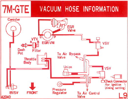

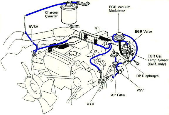

Vacuum Hose Layout for 7MGTE
by Dirgle 03-31-2005, 03:17 PM

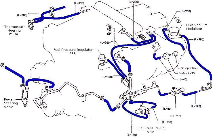

Looks good.
What's VSV stand for? When i first bought the car i thougt it was a Manual Boost controller LOL!

Re: Vacume Hose Layout for 7MGTE
IRC its Vacume Switching Valve
yes VSV= vacuum switching valve... basically its a valve thats controlled by the vacuum from the manifold.
good post with the diagrams....
So what does BVSV stand for?
BVSV stands for Bimetal Vacuum Switching Valve. It's a thermal vacuum switch which uses temperature(coolant temp in our cars) to activate or deactivate the vacuum switch.
Quote:
good call....and ive been looking at one of these for a few things...anyone know if you can get them at any auto parts store? or if im gonna have to custom order some of these bitches lol....
There damn near impossible to get in a parts store, so be careful not to break them. There a dealer item and my dealer was 4 weeks out. So I said screw it and ripped the EGR stuff out. This was when I was in Colorado, now I'm in Cali and wishing I hadn't done that.
Quote:
Oh ideal is WRONG.... a vsv is controled by electricity, NOT by vacum
