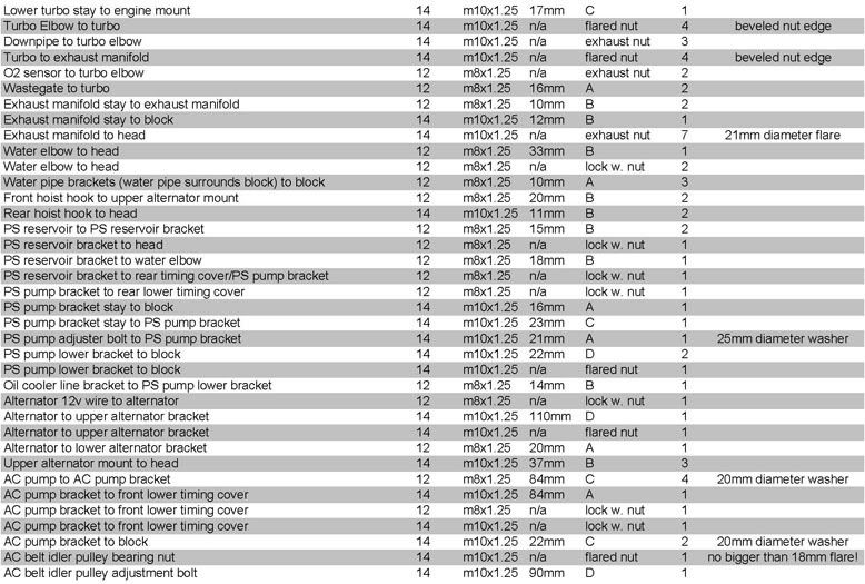

That is a bad ass chart!
I was referring to the nut that goes on the lower half of the actual mount on the 89+ round mounts.
Today I actually rubbed the bolt threads on a piece of paper and brought them to Love ladies which is an insane hardware store in my area about 4x more useful than ace hardware. They have every odd or specialty bolt/nut in the book and the guy in the "bolt room" which is actually a separate room in the store for just this, was able to match the threads and size within 10 seconds.
