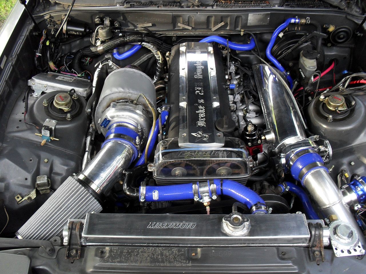

Ya I used the space for ffim and there are plenty gains, one being a not pain in the arse way to do spark plugs :D
Shame bout your car there Ian :/
Pretty serious accident, is there anything you could have actually done with those battery boxes?
<snip>
without a doubt, a beautiful picture of your engine bay. I'm envious; but, I also know to stick to my plan if I ever expect to get it done. There is still some opportunity for improvision... since I don't really have a complete plan. There are certain areas I'm going to have to learn... and money to earn to pay for it all, too.

It was a necessity in my case... 2JZ with FFIM, batt relocated...
again, envious! I profess not to be a mechanic... if I were, this thing would have been finished sooner. My friend thinks I should drop a Hemi in it. I just want to get it back how it was... pretty much, shooting for 500 HP... and I may adjust my plan as I get closer to that number... or not.
beautiful engine!
