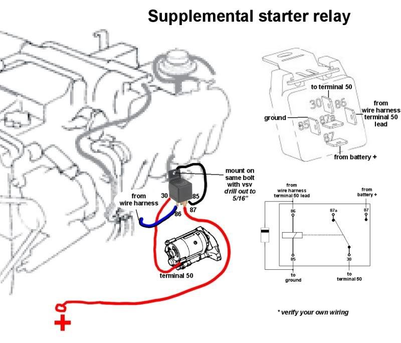

Follow the ignition wire from the starter (small wire) into the dash (possibly behind glove box). It passes through a wire conector that gave me a problem. When the starter just clicks check that wire for 12v. My car had a bad connection at that plug intermittently. Sometimes only 6v would get to the starter making it click. It seemed like a bad starter solonoid.
Also check 12v constant and starter ground.

that looks cool, can I get that relay at any auto store?
And the wire that goes to the starter, is that the little plug?
I want to do that but I don't want to cut anything that is irreversible.
Can you tell me exactly what supplies I need, like what size wire,plugs,etc.
Thanks for the answers, this all really helps.

Yes that relay can be had at advance or autozone. It is a standard 5 wire, but the ones they sell are only for which is ok in this situation as you do need it to rest on a ground.
