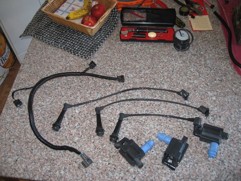

I made a new harness for these, I got anal as usual and resoldered the pins at the connector, and replaced the connectors on the coil end. It's a fairly simple but time consuming process.
Here's all the parts neccesary to make it happen, pretty simple mod now that we know what we're looking for!!
