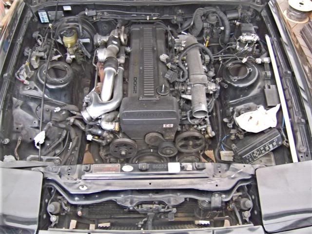

The car is a 1991 JDM Aero Limited edition fitted with an auto 1J-GTE power plant.
The car was imported into the country in 2005 has covered around 70,000 miles with a full Jap service history to boot.
The car was standard when I got it with the only mods being fancy wheels, an aftermarket air filter and blitz dump valve - which was not even connected to work.

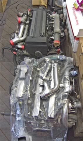

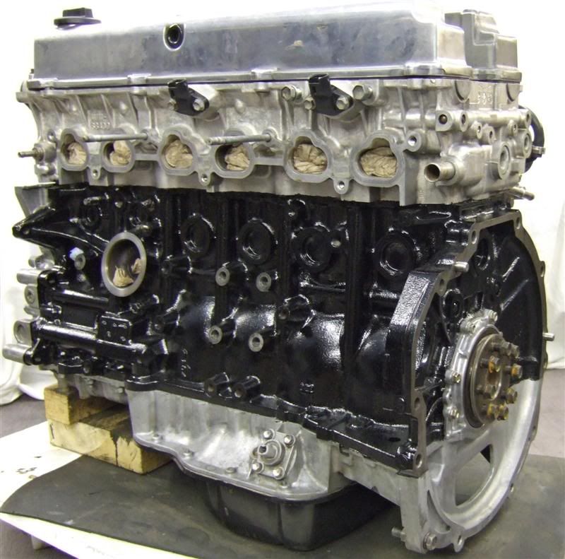

  • Swapping the engine to the spare hybrided unit I have here. The aim is for around 450BHP or over if possible and reliable. This will be fitted with larger injectors, induction, MAP, exhaust, Koyo rad Walbro, 2J intercooler kit (allegedly fits) & standalone ECU - currently reseraching systems & pricing up.

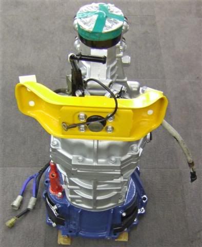

  • Manual transmission swap using 1j bellhousing, flywheel, Sports clutch, manual prop & pedal box.

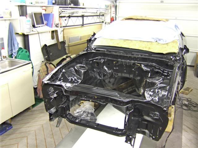

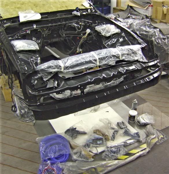

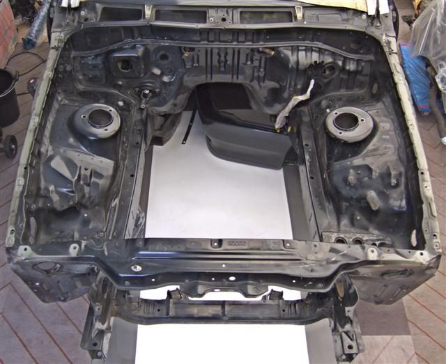

My write off has been totally stripped to the bone - not a single clip, bung or bolt remained on that vehicle, even body panels have been saved!
Can I just politely ask now, please kids don't deluge me with questions about spare parts at present. As and when parts are sorted I will post up items. Thanks.

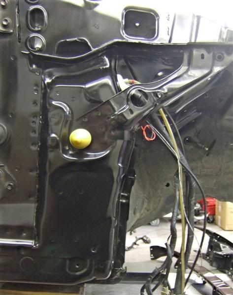

These are sad photos but, I wanted to show people the additional bracing clearly visible in the Aero chassis.
Here you can see the additional bracing in the rear arches which also latches into the doors by a bracket when they close. The brace directly below the top shock mount is always present.
And again, at the bottom of the A pillars you can see additional bracing welded behind the kick panels. The sills of the aero cars are also a much heavier grade high strength steel compared to the hard tops which are standard body thickness.

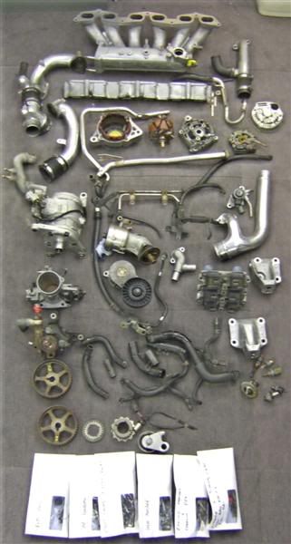

With this shell now gone and boxes of parts at my disposal the strip down of the black car can start.
I have decided to do this in stages:
1)Strip and rebuild the suspension, mod the engine, paint & seal the underside and refit all.

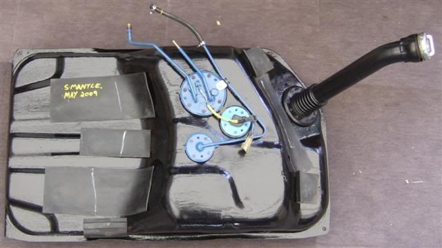

Little tip for emptying & cleaning the fuel tanks without getting covered in the stuff -
Drop tank full, complete with filler neck & electrics.
Tape up the 3 pipes and clean the thing now, wile its sealed up, jet wash, scrubbing brushes whatever, the top will be filthy!
Attach a piece of hose pipe the the outlet nipple - just pushes on. Pop the pipe into a receiving petrol filler or container.
Put some crock clips on the pump power leads - make sure they won't short then, run the thing off a car battery - again keeping sparks away from fuel vapour!!
It just gently empties out the tank to just a few litres. these can then be emptied into a bucket by removing the filler neck - real clean and easy compared to using the drain bung! Leaving the opened tank in direct sunlight for an hour or so will then evaporate any remaining fuel leaving the tank safe and dry.
This tank is in near perfect shape & only requires a little clean up and paint. Walbro needs fitting into here before refitting & will prob clean the sender unit too for good measure.

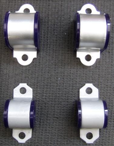

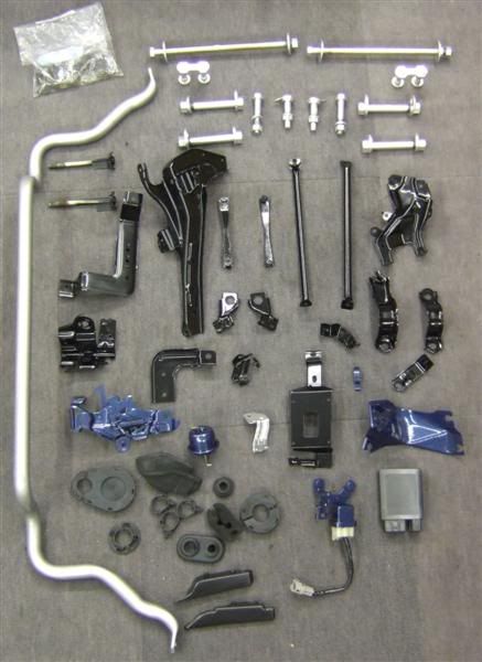

Remember that dirty rear sub frame? Well it's now a rather nice collection of uber clean colour coded chunky bits of metal which, I have to sadly admit, are rather nice just to touch and feel :naughty: Shame they are gonna go back on the underside of the car really!
I have not skimped, every single item, and I mean EVERY single item from the smallest bracket or clip rite up to the fluid line umbilical have been painted in about 5 coats of hammerite.
I am determined for this vehicle not to rust!
The polly bushes are all in and ready to go. I will coat the sub frame with waxoil too during fitting for more rust proofing.
Thought I'd mention this too as, it's not obvious & you'll think your one bush short. One of the bushes on the rear hubs is not a bush at all and is in fact a ball joint. It's item number 42210 HERE All you need to do with this is pull back the rubber and refresh the LM grease inside.
If this ball joint is worn it can cause a "clacking" sound under braking etc.
I will probably offer the sub frame up empty then bolt all the parts back on once it's fixed to the car as it's all jolly easy to get to and means I don't need to wrestle with a huge lump of rather heavy metal!
So, here are all the shiny parts so far:
Sadly, I forgot to put the upper wishbones & all the restored bracketry into this shot, which is a shame. I actually polished the upper wish bones to a bright silver (not mirror tho, that's OTT) and clear coated them.

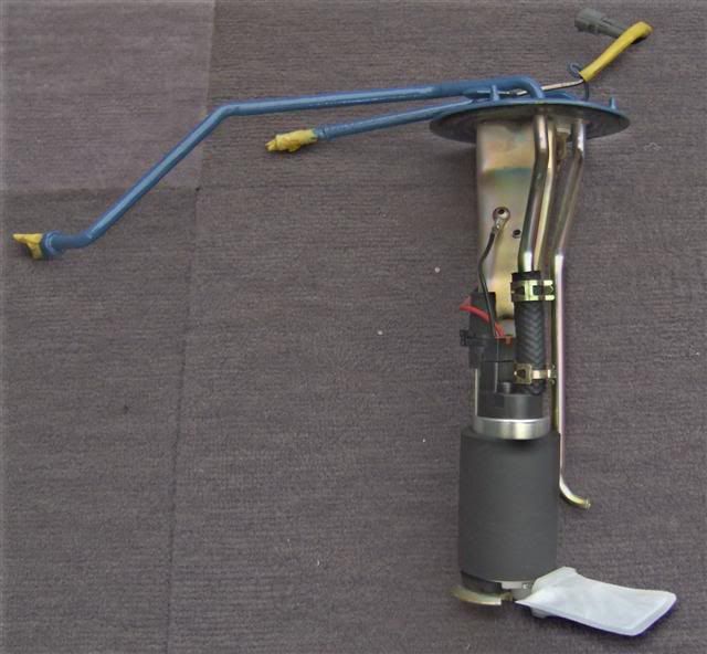

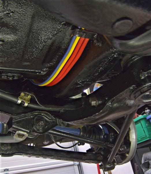

The fuel tank has had around 6 coats of paint, again, I am determined to rust proof this vehicle as much as possible!
I am just awaiting the Walbro pump for the tank, then it can go back in.

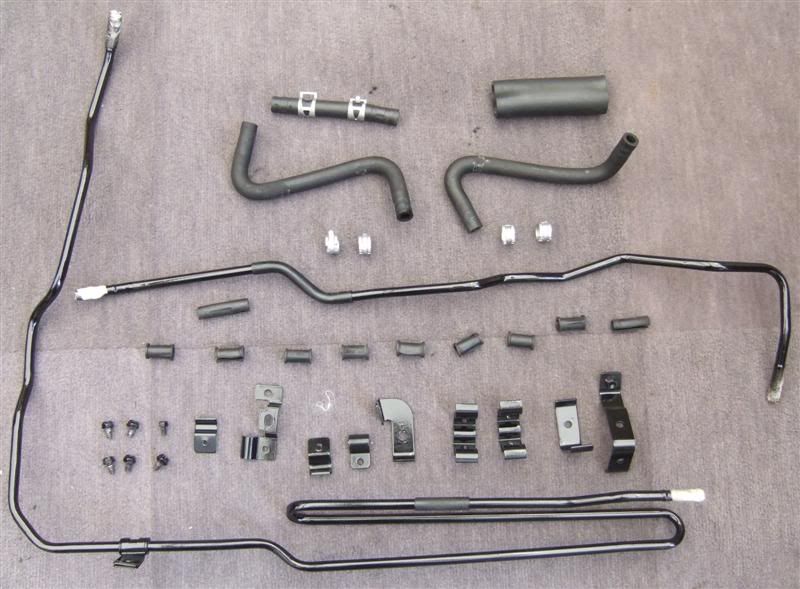

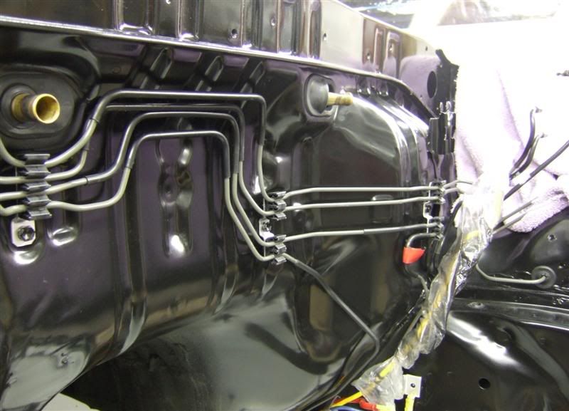

I did get taken in by the choice of paint colours so, red pipes are fuel, yellow are vapour and blue is brake :)
I have put the first coat of under seal on the rear part of the car. going to put a second coat on in places for good measure despite most of it being covered in thick rubber already. I have left the bottom of the wheel well until the fuel tank goes on otherwise I come out from under the car looking like a coal miner!

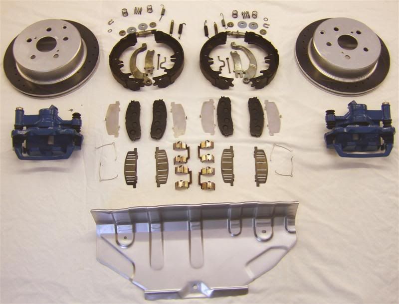

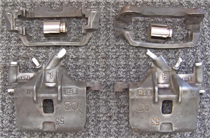

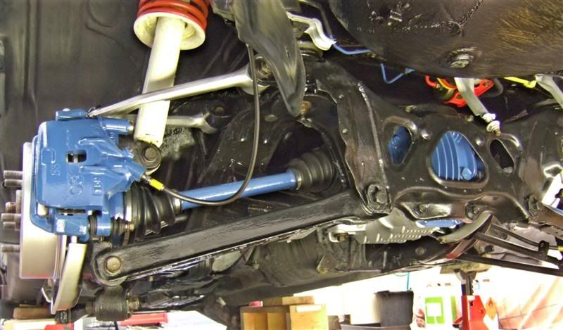

To finish off the preparations of the rear sub frame I had the rear callipers to deal with. Once the 3 layers of paint had been removed (yellow, silver & red) I was absolutely gob smacked by the condition of the callipers underneath.
All I have done to these is paint strip them - that's it! Not a hint of rust! The pistons were all greased up behind the boots so, just pulled out with a pair of snipe nose pliers as a lever - incredible! Always wondered what all the bits said
I had to take a photo just because the condition was so incredible. The fronts are the same.
So, not much needed doing to these at all bar painting and cleaning of some of the components.
This is where my OCD clearly comes out as I set out the parts in a little display ... That's everything you should find on the brakes. Usually the steel shims have dissolved in the yUK thanks to our siht weather and evil salt.

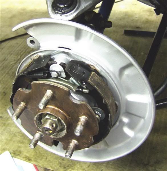

The hand brake stuff was all in great order so, that's all back in and fitted now. All adjusted up too - all easy stuff.

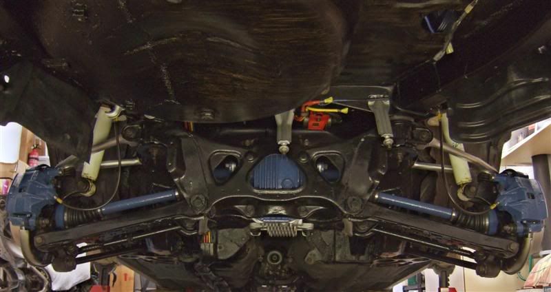

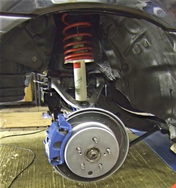

All suspension members have been fitted now, the car put on it's own axles and the whole lot torqued up correctly. Fook me do these things - particularly the cam bolts, torque up hard. About the hardest an 11 stone stick man can manage in fact!
The suspension really is tight with the full polly kit. You can't budge it when jacked up like you can on the rubbers. Only when the cars weight is on it does the suspension move!
went together a dream tho.
Plastic liners now have fixings as if factory. will finish off the edges later in project. They have cleaned up well tho with various cancer inducing chemicals.

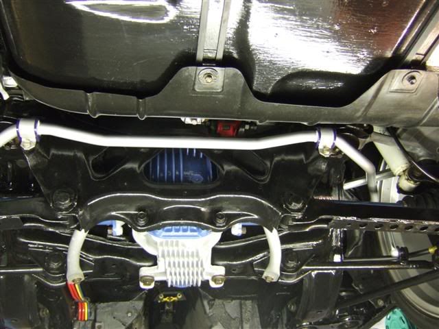

Few shots of the subframe refitted with nice shiny bits: There must be an extra few KG just in paint and wax oil applications!
I personally found the easiest thing to do was to fit the subframe up empty as, it's fairly liftable on your own. Because I'm at home at funny times there tends to be nobody for help so, I have to find ways to do all this one manned if possible.
I managed to fit the diff on my own too by using the grab and roll onto chest method. Wedging my arms against the floor I was then able to lift it into position, hold it there and get the bolts in.
Interestingly that thing weighs 10 stone! I had to sit down for some time in a darkened room after refitting the diff and frame!

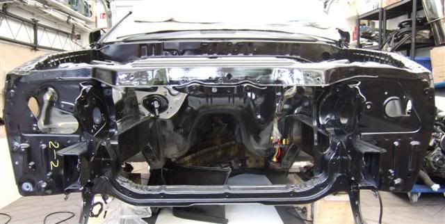

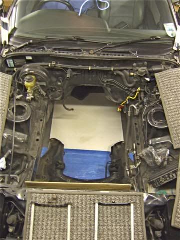

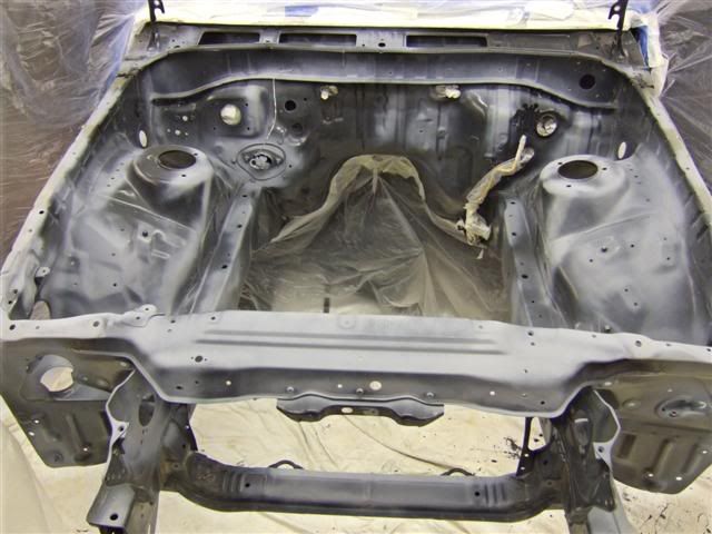

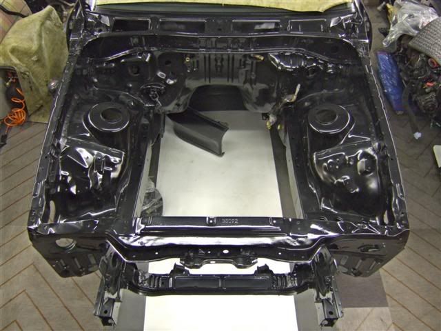

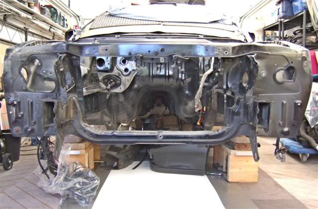

My attention has now turned to destroying the front of the car. So far I have stripped the front sub frame down on-vehicle, as this made it far easier than wrestling with it unattached.
Everything came off super easy. Cracked off the cam bolts and the lower wish bones just swung down free, which was a relief.
Everything is in the same good nick as the back of the car.
I just have a couple of bits to disconnect on the engine then, once my friend drops round the crane I can lift it out and get it on the trolley.

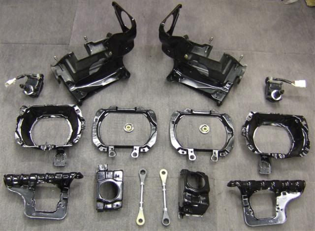

The front nose cone parts are so perfect it's untrue, seems a shame to pull them apart but, in the name of restoration I shall be stripping out all the coolers etc and doing things to them.

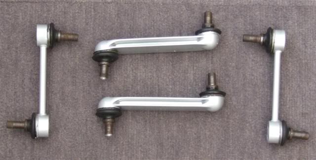

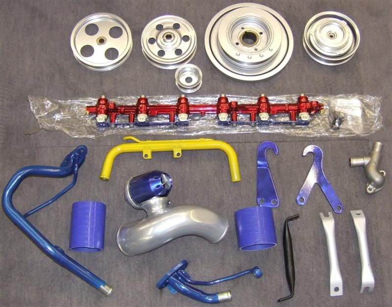

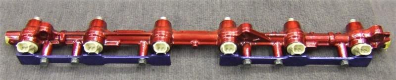

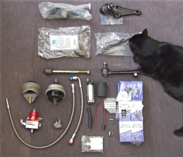

I received some nice new parts this week in the form of the Aeromotive regulator, Walbro and SARD injectors - which happily come with replacement plugs for the loom, Cheers Marty.

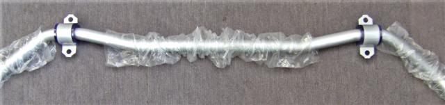

Since the suspension is in small pieces it seems silly to refit old stuff so, I purchased one of THESE kits from the US. 1 Week later it landed in Farnham.
Now, for some car porn blatantly made to look even sexier with use of pussy..
My pussy can clearly be seen gaping at my nipples, yes, my nipples - grease nipples on the new lower ball joints!
Can't remember the last time I saw such a sensible device on a car ball joint & these are cheap!
Anyway I digress, one other pornographic image which has also crept into Supradupra HQ is this fine craft:
A thing of beauty & I thank Kevin and Sheila very much indeed for this :notworthy:

Got the Walbro all fitted into the FP assy and back in the tank.
Tank all put back together and refitted back on the car now which is a relief, I kept moving that thing around daily!

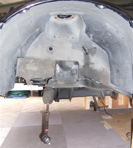

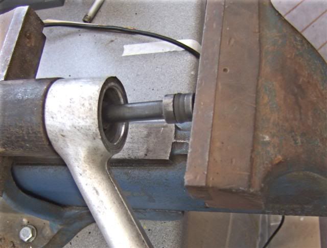

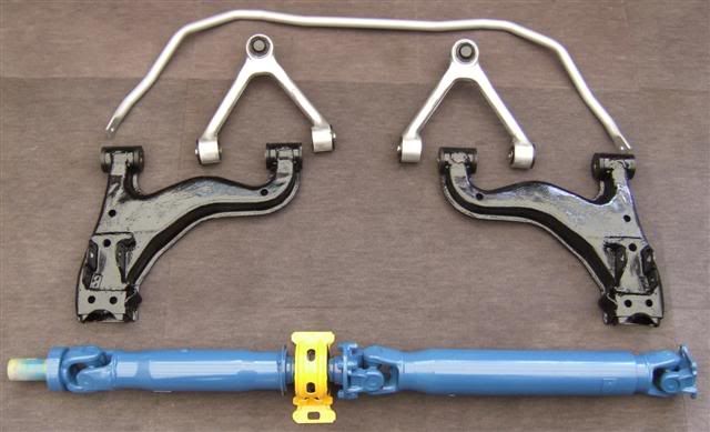

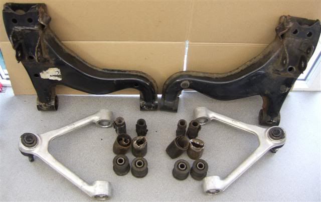

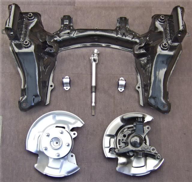

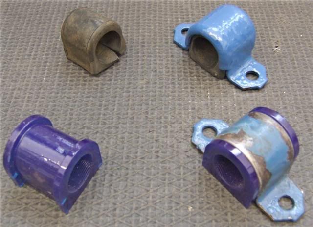

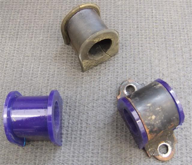

Pushing the front suspension bushes out was pretty easy TBH, the top wishbones just popped straight out in the vice.
The lower ones took a little chiselling to push back the metal collars then, with help from Mum, they just pushed out in the vice with a nice healthy crack, we all like a nice healthy crack....

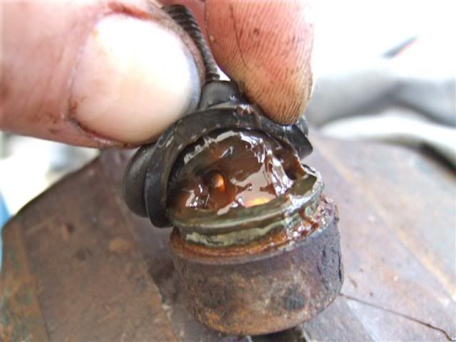

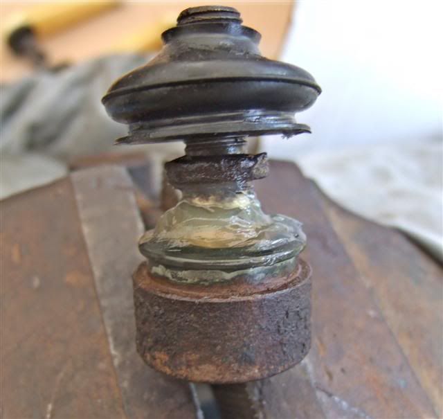

At some point, presumably as a joke, someone filled all the ball joints with poo. This I have now removed and replaced with fresh grease. I also replaced any poor condition rubbers at the same time.
After this they all got cleaned up and painted ready for refitting.
Few more shiny bits. Gave the prop shaft a birthday. Wishbones all painted up and polly bushes fitted ready for installation later on. Everything bagged up and stored now until ready.
My "hover mode" is coming along nicely too

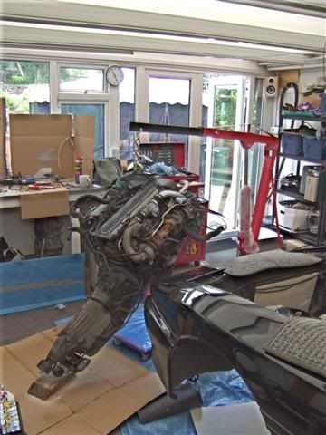

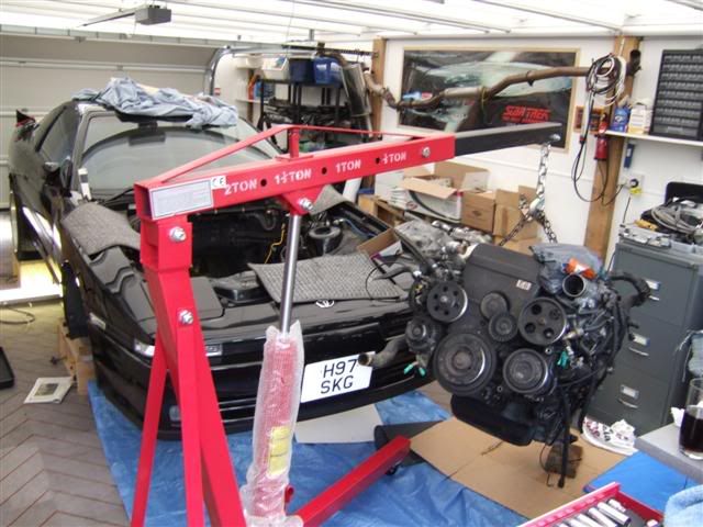

That's it for time being. I am still awaiting the loan of the engine hoist from my friend, once I have this I can pull the engine and remainder of sub frame.
I have pulled the steering rack and am currently attacking that.

As a continuation of the ongoing refurbishment of my suspension, I wanted to fit poly anti roll bar bushes to the supra.
Now, finding ones for the front was not a problem, they are off the shelf even in this pathetic c U ntry so, I just ordered a set from HERE Job done.
The rears however, seem not to exist as far as I can tell. There are some complete rear anti roll kits which come with their own poly bushes but, I was unable to find any - bushes only listed for the rear bar of the MA/JZA70 chassis - definitely not here in the yUK.
So, what I did was measure the diameter of the rear bar then, took a shot in the dark/educated guess as to which other car may have similar bushings & ordered a set of THESE from a Celica. I know there are several "universal" fit bushes out there however, the Celica ones are considerably cheaper :yes:
Now, as you can see from the pic below, the Celica bushings fit slightly differently compared to the standard Supra rear bushes however, with a small modification to the bracket, the Celica bushes can be made to fit perfectly.
(Top) the standard Supra bushes fit internally to the brackets, held in by the folded part of the clamps where as the the Celica ones are the more "standard" fitment (bottom).
By cutting off the folded part of the rear brackets the Celica bushes fit perfectly to the Supra chassis.
And fitted on the bar they looks factory too - perfect retro-fitment.
So, I'm now happy (figure of speech obviously) I have a full set of poly antiroll bar bushes - woo!
All fitted up to the rear sub frame, pretty colour too :)

Update: 19-08-2009
It's that time again, thought I should update this thread so you knew I wasn't slacking too much!
Due to work load & a ferociously busy social schedule , things have been moving slowly the last few weeks however, progress has been made.

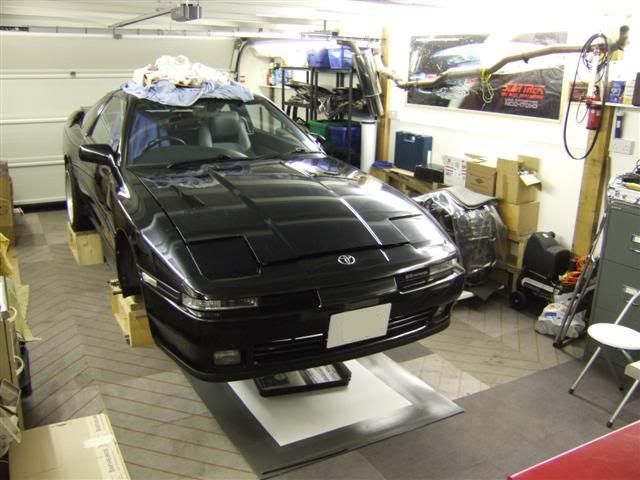

Firstly, this bit had to be unclipped, just disconnect the battery earth lead and your done.....
Had to buy an engine lift for this as, the one I borrowed last time is sadly no longer available but, at least I now have another tool to hand & it folds up nicely to fit in your pocket.
From this exorcise I can confirm my absolute hating for slush boxes has only been compounded. Even after weeks of dripping dry, emptying pipes, removing tubes these things still gush out litres of oil whenever you go near them - totally revolting things to deal with & glad to be shot of it in honesty :yes:
A few more spares :) I could put one front and rear and have a 4WD Supra?
That cleared some handy standing room in the engine bay & allowed me to finally remove the front sub frame.

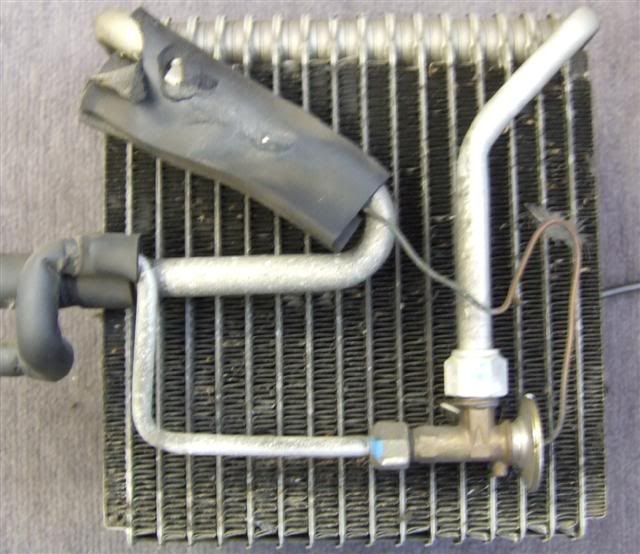

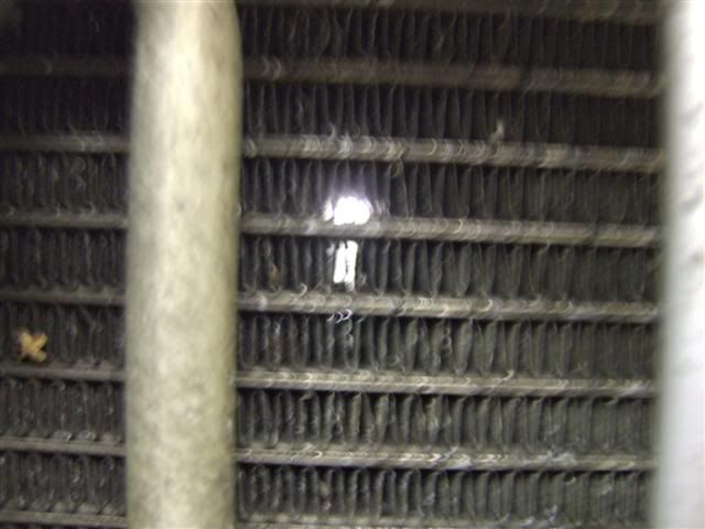

While the AC system is in small bits I decided to clean the evap core. This gets real dirty thanks to the lack of a particulate filter which then decreases it's efficiency & causes that nasty smell after use from the small potato field laying in the core.
This is what's actually in the evap unit (behind glove box)
You can see here how filthy they get, this is even after being blasted with compressed air. Carol Ann would not be able to find this light.... Film reference joke for the kids, but what?
Several baths later, oven cleaner, bleach, more air, detergent & finally Dettol - this was the result :] After this I straitened out any bent fins with a zip tie - a very dull way to spend an evening & fought off Carol Ann who had now taken much interest in, the now, easy to find light :)
While I was doing that, unbelievably the entire front of the car just fell off :)
Ok, so having done it once I got carried away & have ended up licking the engine bay clean so I can respray it black as the scratches just weren't doing it for me!
Just gotta wash this down, rub down a few bits, body wipe it and spray it over. saved a fortune by buying rattle cans off Ebay instead of halfrauds!!

Update 02-09-2009
So, having seen ET as a child I found myself mentally scarred for life & as an adult have suddenly found the need to wrap something in polythene sheeting with random tubes flowing from it...

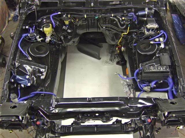

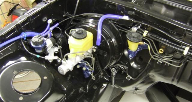

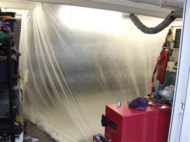

Ok, so this is Supradupra HQ transformed into a Heath Robinson spray chamber in a vain attempt to prevent everything else in the car house being covered in black dust!
Not too much rubbing down to do here I'm happy to say. Just a few areas which either I scratched taking stuff out or rub marks from pipes or wires.
Just sanded down any deep areas then degreased the entire bay & under coated/roughed up.
After much solvent abuse from the spray chamber basically becoming more of a gas chamber lol.
Closure panels also painted as manufacturers never seem to do these - even less so on newer cars made mainly from plastics at the front.
Clear coated a few bits - top firewall & slam panel just to give a smoother finish.
I have no idea what 2-2 means, it was written on the closure panel from the factory so, I just re did it after painting, kinda history type thing I guess / sad gimp!

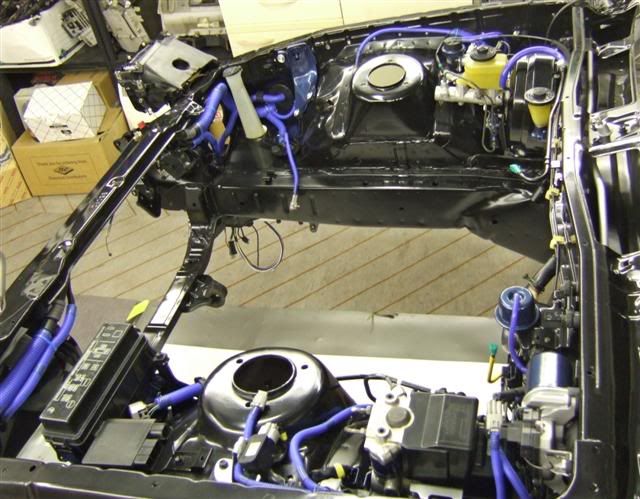

Overall It's tidied up the engine bay nicely & will be easy to touch up in future when the unavoidable scrapes & marks occur. This is about as far as my limited painting skills will go when it comes to the actual car body!
Now the bay is in this state I can start refitting parts as and when they are reconditioned.

Time for another update, not been sitting on my ar5e the last few weeks that's for sure.
Finished off the spraying of the monocot panels. This not only adds rustproofing it also makes things look much tidier when you peer into things.
When you start one of these builds it soon becomes apparent any time scale you had was complete fantasy when you suddenly find just one cooler turns into this many parts!

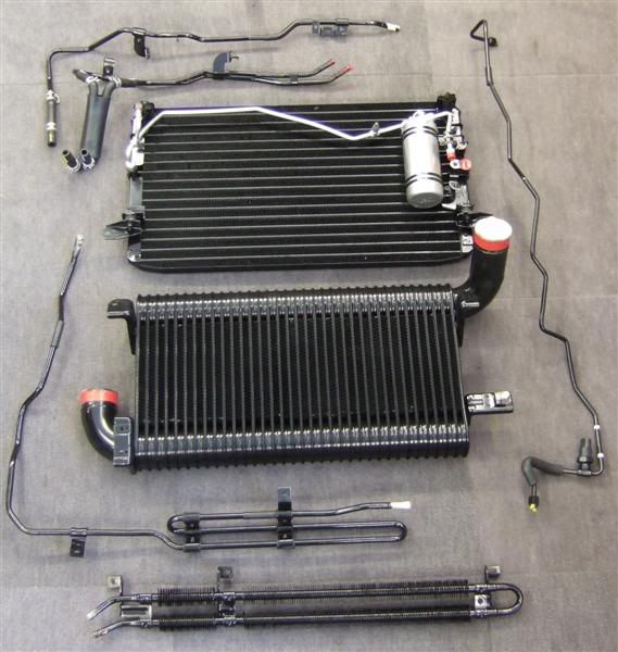

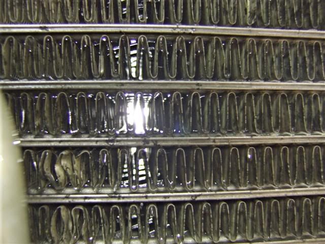

That was just a start, I reconditioned all the coolers, cleaned, any bent fins straitened out then enamelled.

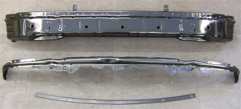

Bumper & nose cone cross members done.
More bracketry & refurbed plastics than you can shake a stick at & there's still plenty to do!

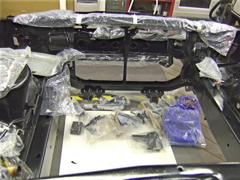

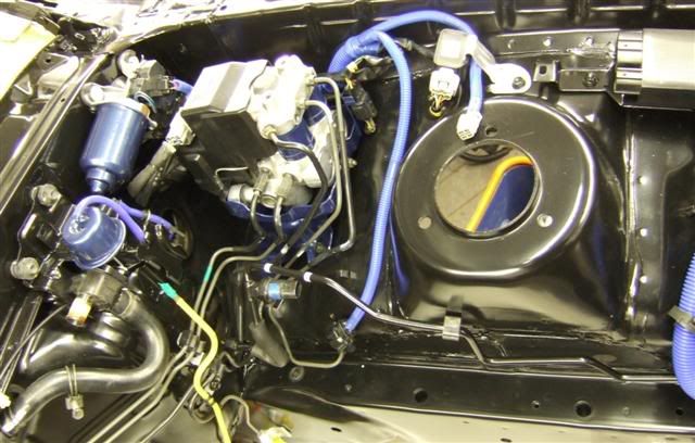

Refitting of hydraulic lines. As you can see the 4th pipe indicating this car will be fitted with a real gearbox :) I was going to paint these but, when I cleaned them up to find they literally were like new I just didn't have the heart or need to cover them up. They are more stealth this way anyhoo.
Some of the front components trial fitted mainly to get the cooler brackets & clamps all assembled in the correct positions before final installation.
There is a serious amount of really heavy gauge metal in the front of one of these things!
Close up of the finish I'm attempting to achieve. It's no concourse runner that's for sure! I just want it looking as "out of factory" as possible before I use & abuse it come sun, rain or snow.
Got a few more parts through today, mainly new vac lines to replace old rubber ones & the wiring loom stuff.
Need to get onto the new ECU system & make a shopping list for Mr. T as the engine tart up is getting ever closer :yes:
Still some big stuff to recon such as the r154, front brakes & flip up assemblies. As well as a whole load more brackets! :banghead:
Hopefully get the remainder of the underside covered in some new underseal. Waxoil some parts & refit the front suspension members.

It's that time again, I'm sure you all can't wait for this latest instalment of bracketry photographed in captivity!
First up, I'd like to boast I have now been allowed to upgrade from the "Early learner" pedal set with the large novelty sized speDal pedals, to a full set of adult pedals :) :duck:

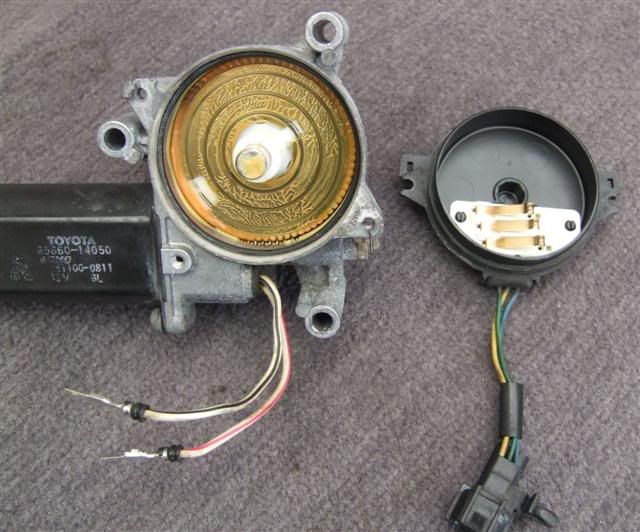

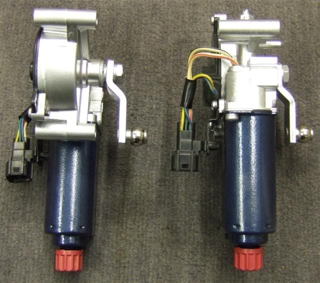

Ever wondered what was inside one of these? For those of you who still believe in the "pop-up fairies" look away now.
Refurbished along with all the pop-up & headlight gear...Hours of fun for all the family.

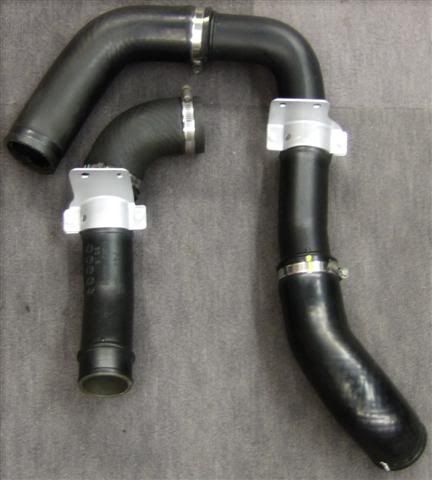

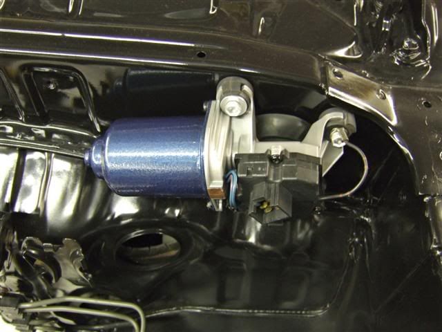

Wiper motor & boost pipework got the same treatment. Anyone ever seen that book of boring post cards?....AKhemmm..
The boost pipework photographed here in a secret (accidental) "soft" mode making it look young and beautiful A mode which never seems to be available when the camera is pointed in my direction...

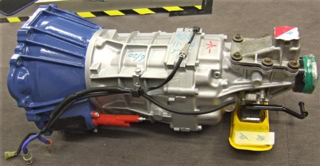

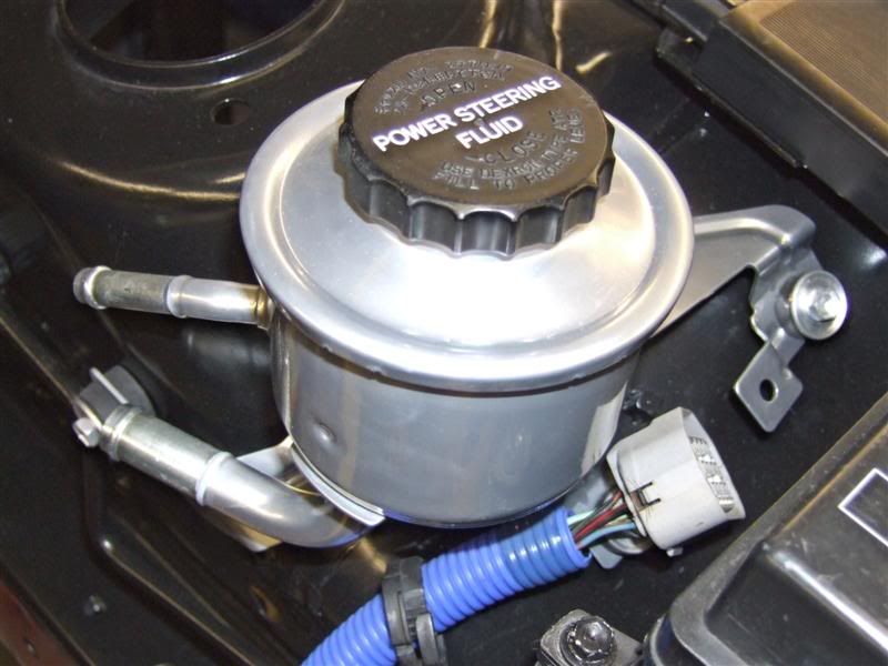

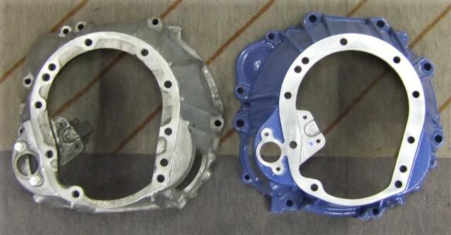

7M against 1J (blue) bell housing. The 1j bell is quite a lot shallower, between 1-2 CM. I saw a magazine once filled with pictures of varying bell housings. All different shapes, sizes & colours. I remember I had to reach quite high to get it off the shelf at the news agents, had an exotic name..
Made this look pretty:
There was some random stuff scrawled on the top of the R154 which I restored for (add attempted reasoning behind this act here)
Some random numbers, some Japanese & what appears to be Klingon - explaining the r154's incredible ability to hide reverse on occasions, this must clearly be a cloaking device, hence the Klingon.

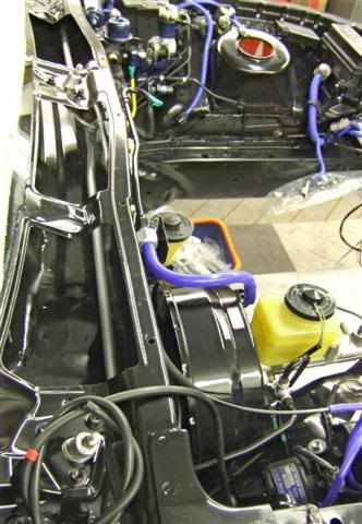

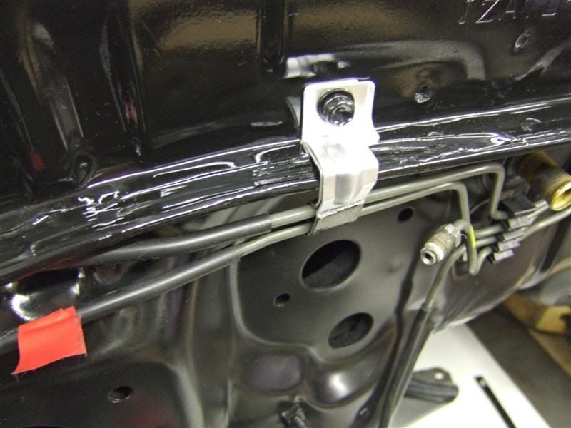

I have spent many hours on my hands and knees pulling apart the chassis loom, cleaning it & recovering it in, well, blue obviously!
Wiper mechanisms refitted after reconditioning. Seriously exciting stuff this....
We have some cruise and brake stuff on this side but, most importantly some clutch hydraulics :yes:
We have some ABS, climate, ignition & wiper stuff on this side.
And yeah, this is what it looks like if you hold the camera somewhere else - wooness!

* Complete suspension rebuild front and back, full polly pushings, Tokico TEMS shocks, spax springs, strut braces & anything else which requires replacement during build. Complete.

Attention has turned to the 1jz engine now & giving it a bit of a face lift.
OK so I got a little more carried away than first planned. This little lot fell off so, I thought I may as well clean it up a bit & service a few items while there.
I'm not going to go mad with this..... No really. It will all be clean but, I'll be keeping much of the alloy natural. Much as paint and powder coat looks very pretty, after a few years it will crack & peel on an engine which, just looks rubbish. Besides, there is something genuine about a clean natural finish part. Obviously I'll be buffing up Adi's polishing work :yes:

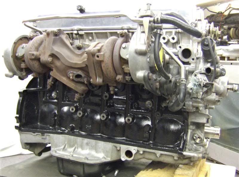

The block cleaned down well. At some point in it's life the oil changes were strung out a tad resulting in a burnt oil build up in the valve covers. This is purely cosmetic, inspection of the bearings, filters, oil ways etc shows no problems & all is clean on the feed side of things where it's important. a Bum-O-Scope camera came in very useful for this inspection.
So, introducing a naked 1JZ-GTE:-
The 1J engines are a superbly no nonsense design. all the troublesome bollox fitted to the 7M such as FPU, EGR, MAF, CPS was thrown in the bin & this no nonsense unit was produced.
Toyota went OTT after the 7M gasket issues & made EVERY gasket on this engine metal. The troublesome rubber hoses round the rear of the block have been replaced with all metal construction & the amount of rubber piping is dramatically reduced.
The CPS sensor which was always a nuisance to install on the M has been replaced with 2 fixed hall effect cam sensors & a crank sensor triggered by a wheel on the cam belt pulley - no getting these a tooth out!
After all this it then seems odd Toyota went and plonked an incredibly complex & component heavy Hydraulic cooling fan system on this engine instead of opting for twin electrics?!

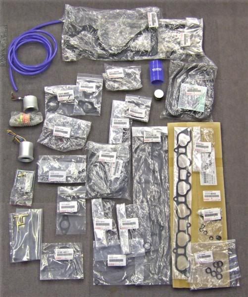

On the 17th Dec I sent a parts quote request to Toyota who kindly returned it same day & an order was made for the engine bits.
On the 23rd Dec Xmas came early :)
A friend of mine lent me his powder coating system to do the engine parts. An ebay bargain industrial sized oven has proved most useful for this!
I have had much success with this & it's such a simple process. Only down side is it seems I'm slightly allergic to either the powder or the gases given off by the baking so, I have to do this outside hiding under gazebos!

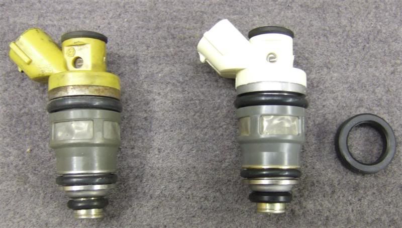

SARD 540's & stock injectors with new insulators.
One day I'd like to learn how to play this flute. I think it's broken as not so much as a farting noise can be made....
Still not having much luck with the flute..... It's dark outside so, must be yUK time 3pm....

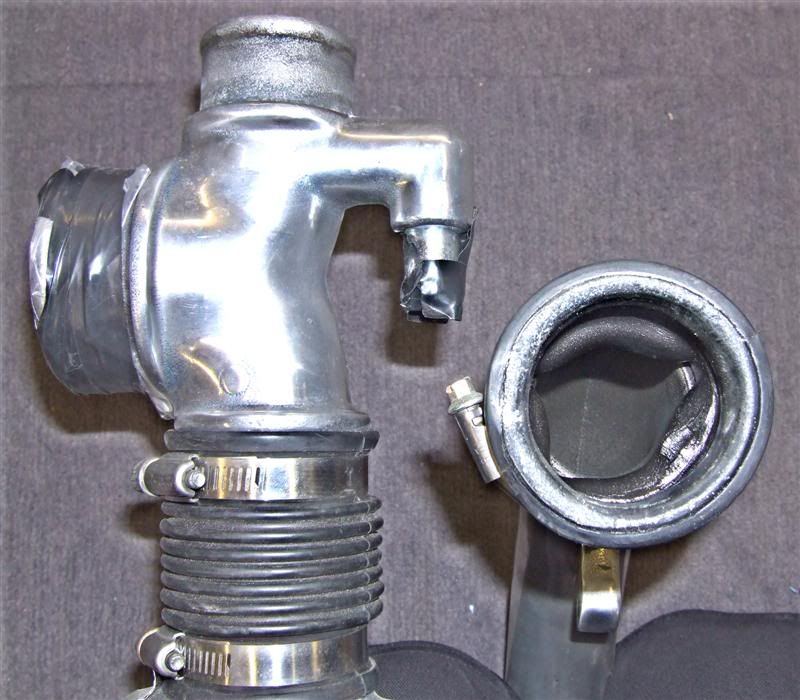

I touched on this in another thread. Toyota revised the 1Jz PCV system a few years into it's life by putting the PCV pick up pipe onto the metal pipe into the front turbo instead of having it connect to the "T" as on the earlier engines.
This image shamelessly stolen from another site - do I care? NO, it's a picture of my sodding engine!! lol.
I believe the reason for this mod was to stop PCV vapour swelling the rubber bellows as below, which would restrict inlet air flow considerably over time.

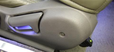

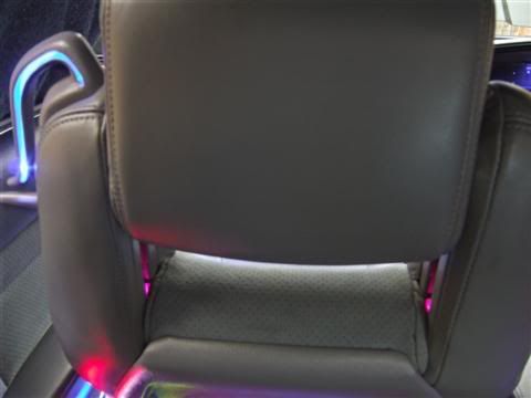

holly bonkers! thats amazing! can you get another close up on the interior lights? what do all those buttons on the steering wheel do?

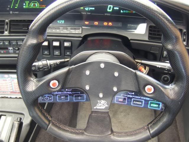

Thanks everyone for the feedback, it's great to share an interest with others, particularly world wide. I've not set out to make some sort of show stopper or museum piece, I just want the bl00dy thing to last another 20 years & pref not be dissolved by our climate over here in the yUK!

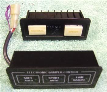

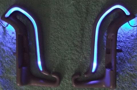

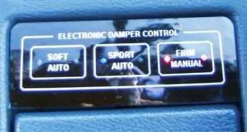

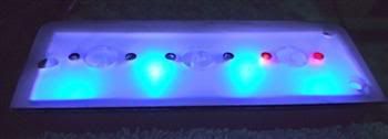

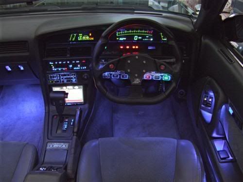

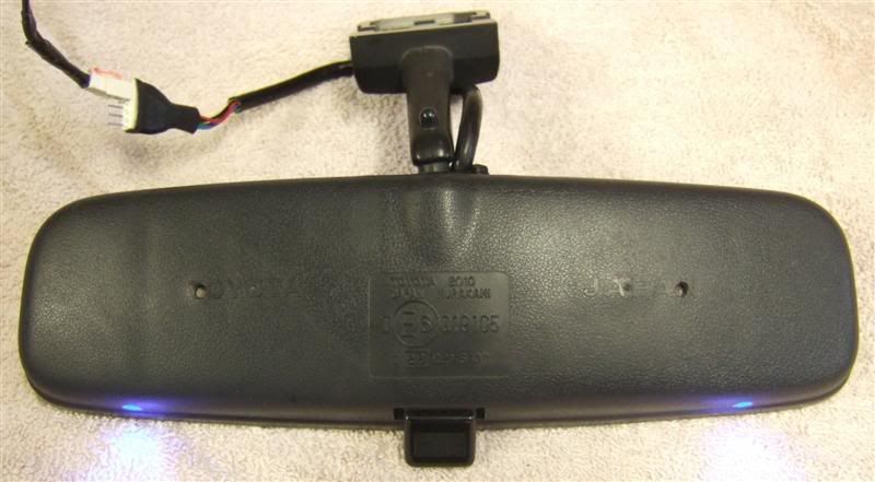

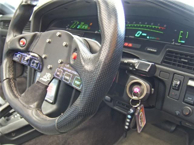

Below is the thread I did on the steering wheel from my home forum, hopefully it explains a few of the interior bits, I know interior lighting is not everyone's cup of tea but, I'm attempting to make things look factory.
It's hard to photograph lighting like this so, it tends to look incredibly bright on the digital cameras compared to real life!

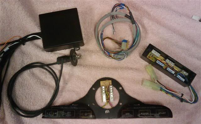

Steering wheel start/cruise Rebuilt Sept 2008, first fitted to my old supra around 2002.
So.... New car, time to rebuild the steering wheel control system and transponder key controller.

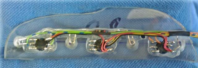

First up was to re-make the actual plastics for the switches to be housed in. These needed redeveloping as, I wanted to illuminate them blue to match the rest of the car - the old system was green & did not allow me to change the colour.
So - the panels start life as a shaped bit of perspex which is routed & drilled out to allow the switches and wiring to be concealed inside them - the panels are made of 3 parts - rear component part, front former/lens then the print.
It's all very small and fiddly, not really much point in going into depth here as this posts just really for peoples boredom!
The front part mounts over the rear component side sealing everything up, these are then mounted to a bracket which mounts up behind the steering wheel. The tiny cables come out the rear and directly inside the steering boss to keep them concealed behind everything.

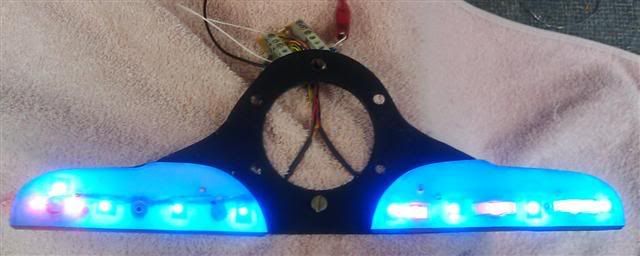

The last model featured LEDs next to the OFF, POWER & START buttons that "flip flopped" depending on what option could be selected. This time around I have used lit push buttons.
These allowed me to light up the words of each button individually instead of the LEDs. This involved having to make up a small shaped light diffuser behind each button to spread the light evenly - bit of optics there thrown in to keep me on my toes!
Cameras hate photographing these things but, you get the jest!

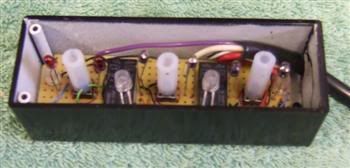

The little circuit board attached, mounts up inside the steering boss and houses connectors for the umbilical cable and components for the cruise buttons.
Here they are with the screens fitted.
All switches are lit here as a test, usually when in operation, only the buttons of options that can be chosen are lit, so for instance, if the ignitions on, OFF & START will light, if the cars started only OFF will light - get the idea?

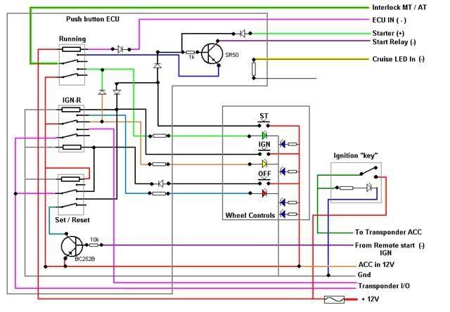

Obviously this stuff don't just plug and play, a circuit is required to drive it! This is all set out as follows:
1) The transponder key dock - this fits where the ignition key was, when the key is inserted it lights up (fades colours) and sends a signal to ...
2) The Transponder key ECU (big black box) Basically this is an immobiliser type device thats been tinkered with to allow my ECU to take control of certain things. It switches all 3 power systems , ACC, IG1 & IG2.
3) The push button ECU - this is the smaller long box, this is the heart of the actual controls, this interfaces with my alarm system remote start & power control, the car ECU and the transponder ECU.
4) The umbilical - this is the grey cable, its made using super flexible cables - same as those on a domestic telephone cord, they comprise thin copper threads wound round nylon cores insulated with PTFE coating. They are incredibly flexible and don't break with continued movement - ideal for wrapping round a steering boss and moving with the wheel.
5) the control panel assy.
So - how does it all work - erm far too dull to go into for people but, the circuit for the ECU is below - that's how it works .... all clear on that? good
In short, the transponder key gets read when inserted (he he, i said inserted again), this switches on the panel and the options that can be selected (Power & start) light up. It also brings on the car AV & ACC systems like key position 1.
Pressing power just brings on the ignition power.
Pressing start will automatically turn on the ignition then my ECU ask the TCCS if the engines ready then cranks it for an automated amount of time till the engine fires up - giving the TCCS control over cranking means the engine fires up in a second - tiz great!
If remote start has been triggered using the alarm - the control circuit receives a command from the alarm so, when the transponder is inserted the system automatically switches to running and allows you to drive off without pressing a single button - simple!
The car will only crank if the safety systems say OK - so N gear, brake etc, the car will not move without the transponder docked and if attempted the power shuts off instantly and the alarm sounds.
To turn off you either press stop or - just pull the transponder out its dock - the car shuts down automatically - kind of fail safe system.
All this fits neatly up in the dash, hidden away. It uses all standard commands and also shares commands to & from the alarm ECU - this dramatically reduced the components required to make all this work and halved the cabling from my original MA70 system.
All fitted and working.
Dock is pretty much same as my old one, the stock key light has been replaced with the status indicator of the new system so, flashes and lights to tell you to insert the transponder etc - handy.
Thats it, has been keeping me busy for a week that! Lots of head scratching and investigation into how to interface with the TCCS and alarm ECUs - the joy!
Automatic tail lights, head lights & wipers Built June 2008.
Been tinkering again and adding a few systems to the Aero to bring the electrics up to date.

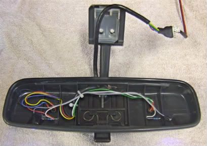

Now have my auto lights installed - these switch the side lights on at low light then the headlights on when dark.
Managed to be a bit sneaky with the sensors this time around and fitted them inside the rear view mirror. just so happens there are 2 hollow dimples inside the casing which the light sensors fit into perfectly!
Also added my interior "ambient" lights - again this time around I have been able to fit the LEDs inside the rear view mirror which means they are completely invisible! These just give a gentle blue glow inside the cockpit.
While in the mood for automation I also fitted rain sensing wipers, this consists of a small ECU and a wind shield mounted sensor.
The sensor again hides behind the rear view mirror and the ECU locates in the passenger kick well.
All the wiring is kept local and just taps into the stock harness at the wiper control relay box, only mod required is a diode in one of the lines.
Both systems can be switched off and neither interfere with the standard functioning of the stock controls.
If the front wipers are going & reverse is selected, the rear wiper will come on to wipe the rear screen & stay on until reverse is disengaged - bit like modern cars do now.
Keeps me off the streets!
Custom TEMS panel
Built July 2008
Sorted this out this weekend, managed to make a controller up that fitted perfectly into stock location on stock plug plus one additional wire for the manual firm override.
The box of tricks:
Screen layer fitted with all new self adjusting switch actuators for the membrane panel - be excited..... woo!
Comparison to the rather flaky stock thing with buttons so large the car rocked when they were pressed...
The keys are now tactile soft touch, even a southern poof could operate them...
Lit up - blue ... obviously!
Fitted, just pops in place of original, run 1 additional cable to passenger kick panel to pick up firm override.
Thats it!
Working on some more up to date / funky screens to go on these, loose the square look, same for steering controls... watch this space i guess....
Interior lighting the Aero Around Aug 2008
As per title, this thread will not aid anybody nor does it offer any helpful information, it is merely demonstrating the latest frivolous exploits of a guy who should get out more and a soldering iron!
To a lighting engineer the lurid spar5eness of a pitch black car interior at night is a venerable play ground, posing challenges to keep ones mind ticking along and ones fingers grazed! It also proliferates the use of colourful metaphors...
With more and more cars these days taking time to implement ambient lighting, I find I can justify these actions of mine! And keep kicking myself I didn’t pursue a profession in it 15 years ago when you never ever saw it! – darn!
This week I turned my attention to the seats which have always been a fairly simple affair in my last cars.
As you can see nothing out of the ordinary in this picture..
In this one however the application of electrical current to an LED secreted into a seemingly impossible space lights through a light guide shaped and fitted into the seat belt guide handle causing a pleasant blue glow - No more shall it’s dark slit play with my mind…
While in the seats I decided a very subtle pinky/purple glow would add a needed splash of interest and colour to the head rest guide rails.
Ever since owning the Supra, the persistent random pawing about by passengers trying to find my knob has posed a problem. Now there is no excuse..
Clearly it's now in plain sight ready for a good pull..
There we go, like I said, nothing mildly useful apart from maybe raising a smile & posing the question why - just why?!
