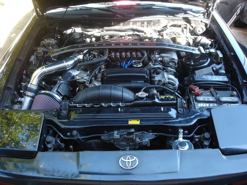

Here's mine, simple use of the ebay kit. btw i am still waiting to get some pics of the shifter, been very busy at school

hmm i like that... what is that your using instead of the AFM? and how does it work compared to the afm,, as far as like fuel cut and all that goes?
also where is your tube from the ISC going to? usualy it goes into the turbo intake right?

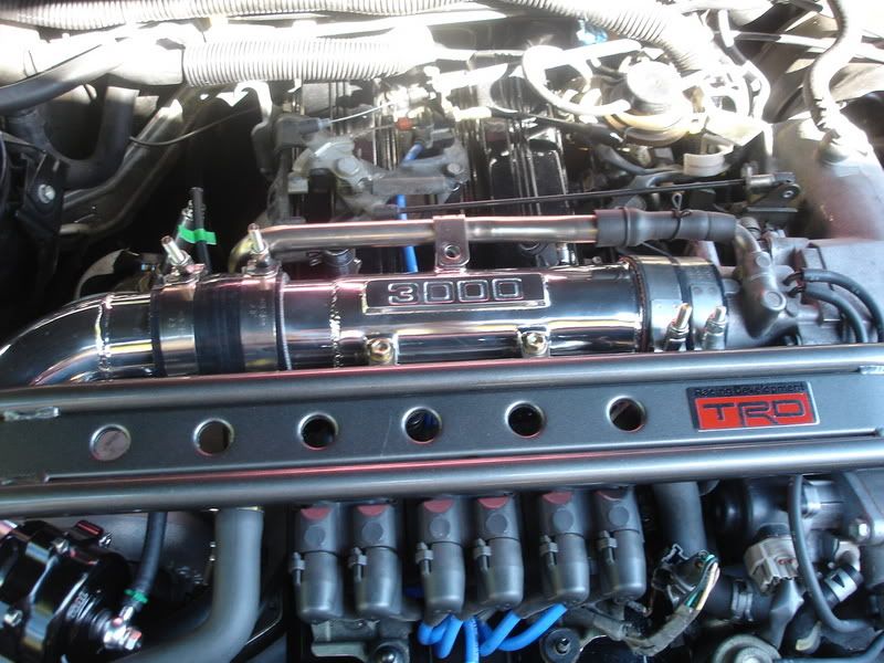

#6
U-bends from JC Whitney ~$18 each and a good pal around to help cut and weld them together. Some hi-temp brake caliper paint and here you have it.

#8
http://www.jcwhitney.com/autoparts/...0101/Ntk-AllTextSearchGroup?Ntt=mandrel+bends
I just bought bends from there, and with a friend on the forum (boostedstr8six) cut them to the size and angles that we wanted. Welded, then sanded off the welds to a smooth finish. From there i just painted them and welded the little 1'' tube end for the Bosch 110 bypass. Bought some 4ply couplers to go w/ the color scheme from suprasport and that was it. Takes some welding skill and a perfectionist attitude to get that clean look but definitely a DIY job.
I hate the look of blue couplers in engine bays and mismatched color schemes Like polished this and faded rusted that w/ mismatched colored vacuum lines. so I went with this so only a knowledgeable eye could catch it. Those that dont really know supra's would not tell the difference from stock which was my goal. I didnt want the silicon couplers/vacuum lines/ hoses, afm delete, injectors, turbo, or anything else to be an eyesore and instead just blend them in.

it is a maft in blow thru, you might want to do a search on it cause its alot to explain lol. yes that isc pipe normally goes to the accordian but it works fine how i have it connected also.

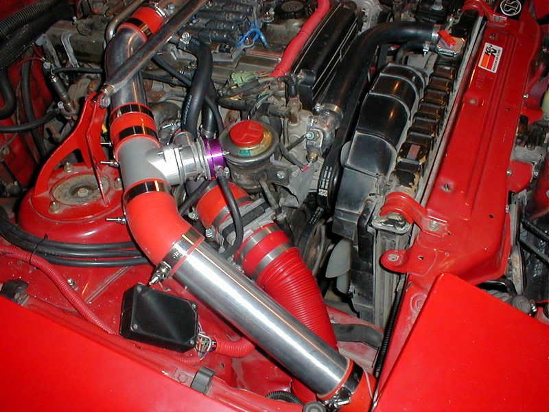

I know, lots of couplers but it holds 11lbs of boost so...
Better than factory and done on a budget.
I thinks welded pipes are fugly anyways, even the best welds.

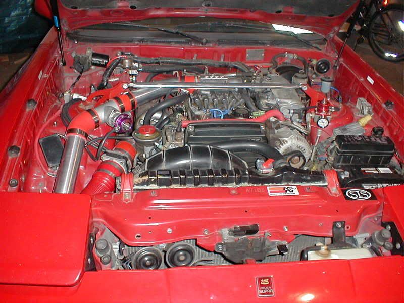

Here is my current setup. (It is much like I did last time around, only slightly changed for the new turbo, and going to the Translator Pro/Speed Density setup.)
Pipes are just Mandrel bends, cut and welded, smoothed and then powdercoated candy apple red in this case. (With clear coat.)
Matches the engine underneath it all right? LOL
You finaly working on it again? or do i need to come over again and give some motivation? LOL i finaly started working on my engine again!
And the piping is very nicely done
