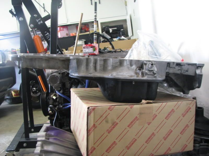

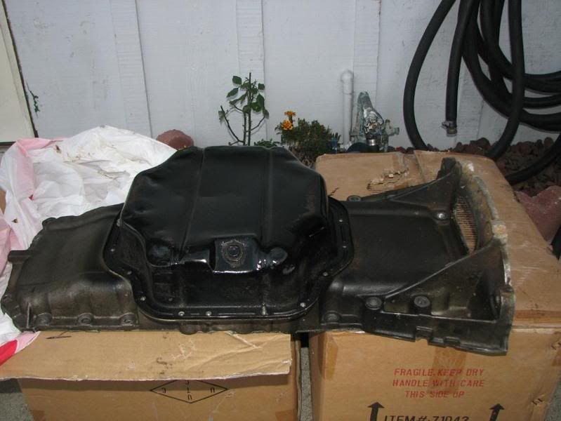

the picture i have should be the furthest back you can go - it came off the 1jz and from what i remember it looked the exact same as the sc300's

Just to clarify, I thought that there were only 2 upper pans, front sump and mid sump. There are 3 lower pans, Front/Front and Mid/Mid and also Mid/Rear. However, when you look at the top picture that TLO86 posted, that is a 3rd upper pan unlike these two.
exactly! :D did the mid/rear setup work or do you need to modify the pan?
