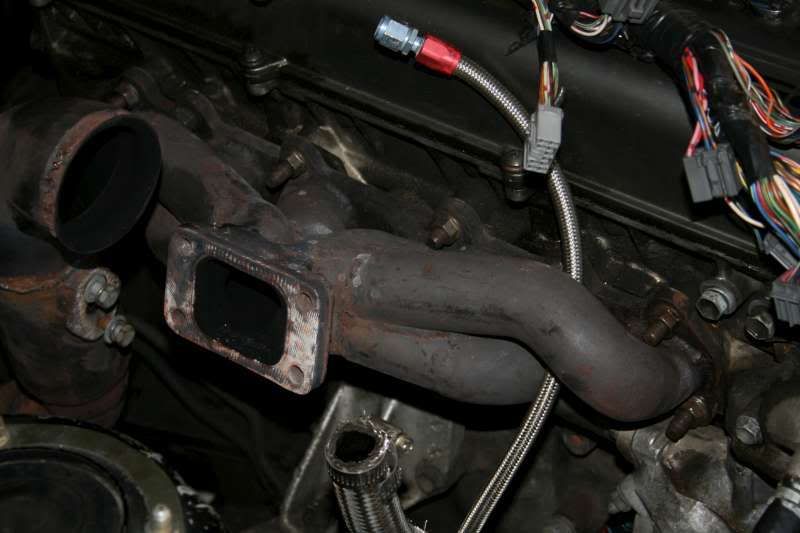

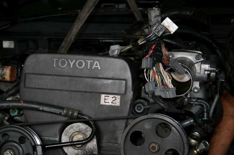

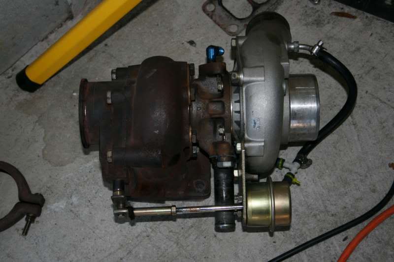

Old T3/T4
Single Manifold

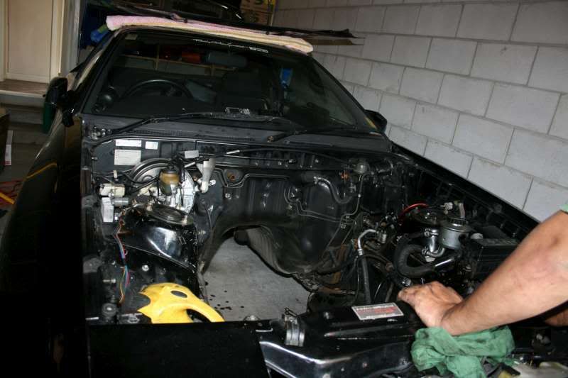

Engine ready to come out

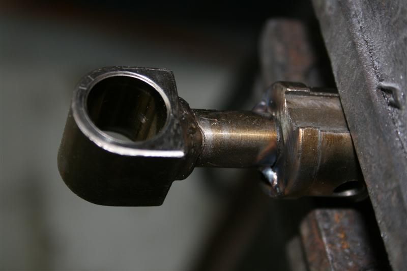

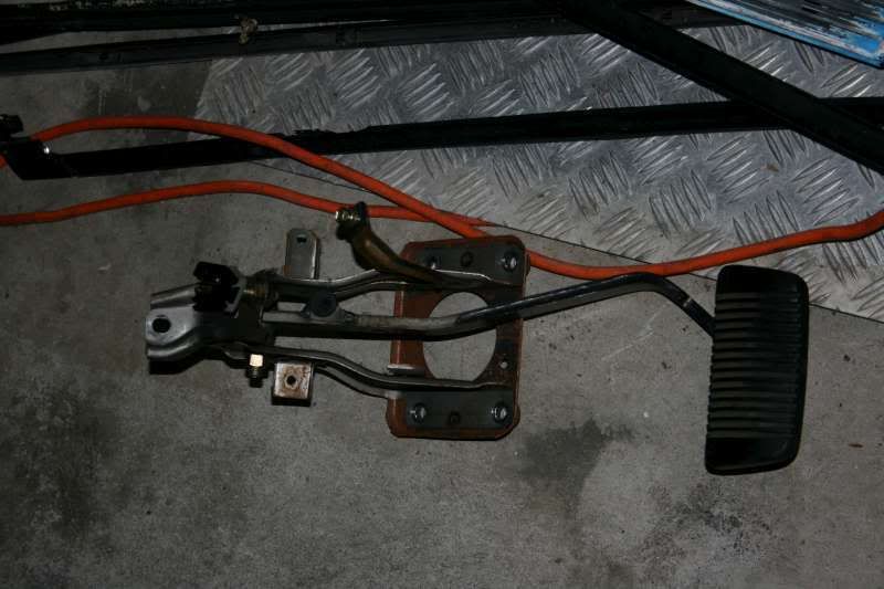

Manual Pedal - well i think it is... might have already been swappen out already :p

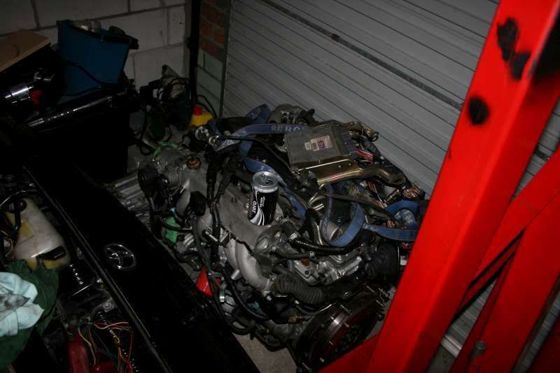

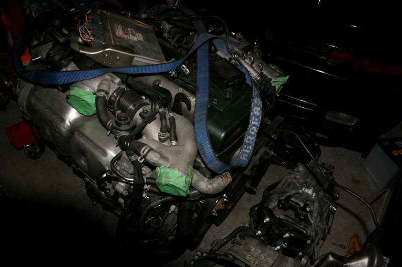

2JZGTE sitting.... Waiting...

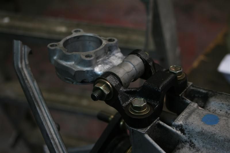

Clutch Master Cylinder

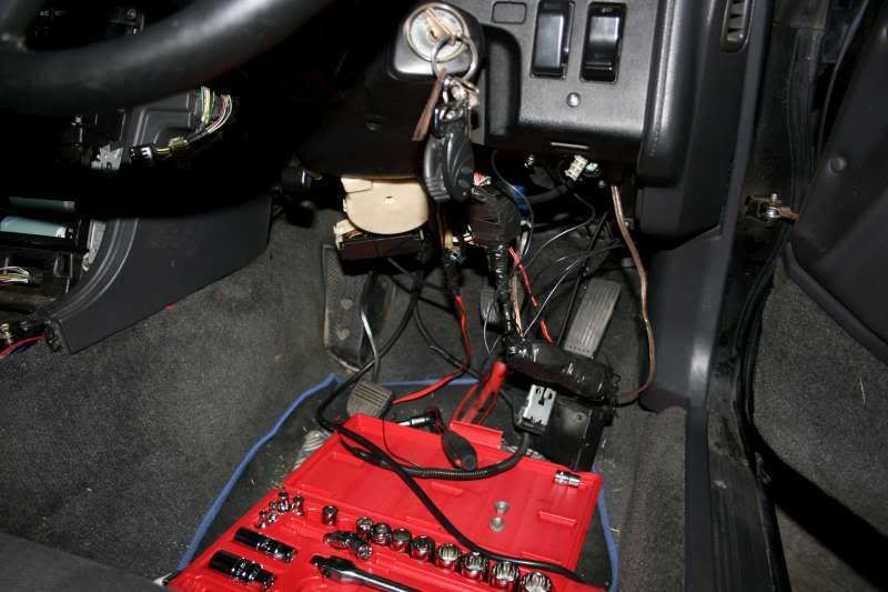

Wiring mess under dash... removed old alarm :eek:

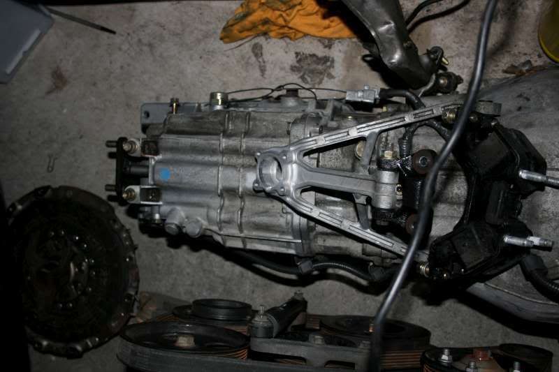

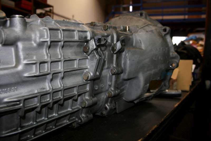

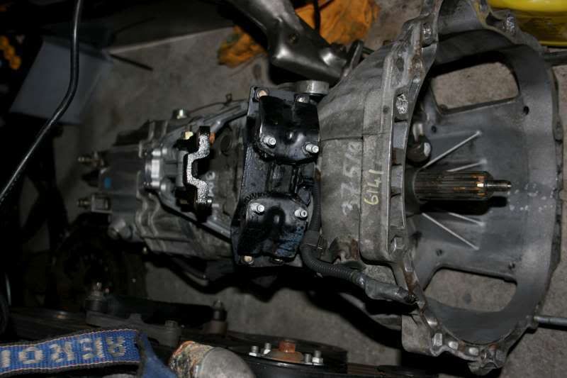

Getrag 6 Speed!!!!

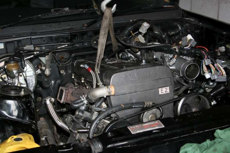

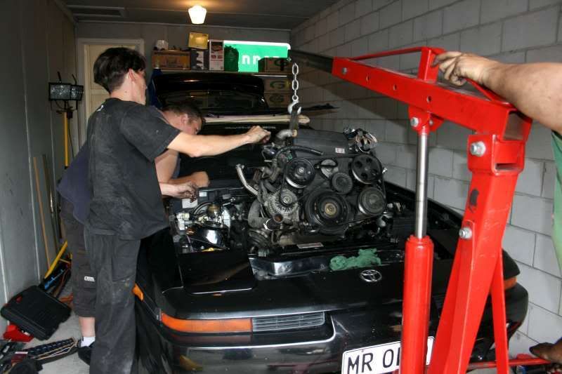

Lift that 1JZ out!!!!

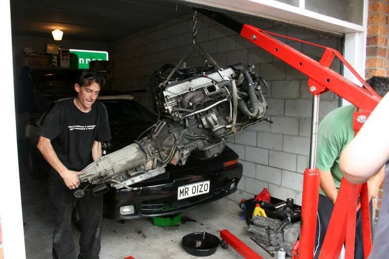

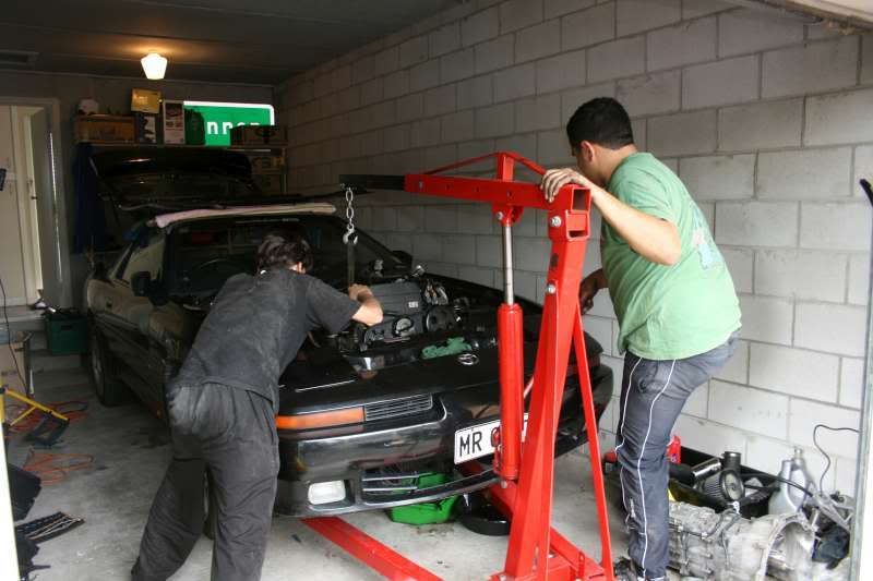

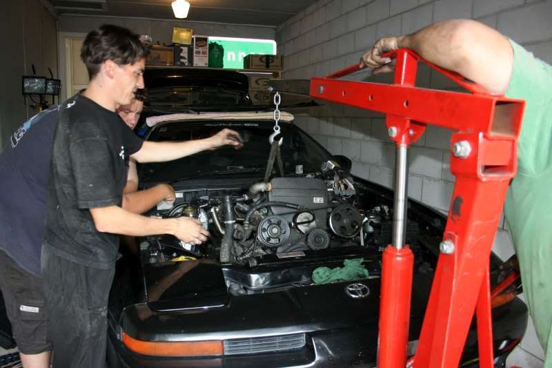

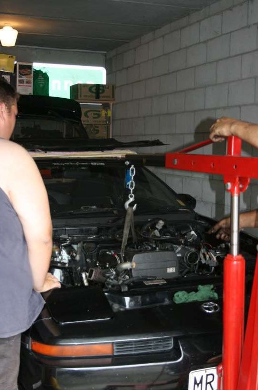

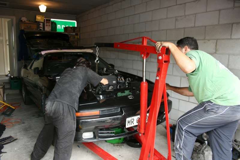

Once the engine arrived, we had the old 1JZGTE out and had the new 2JZGTE and V160 dummy fitted in just to see how it all sat.. No worries here. Things sat very nice. Used the JZA70 mounts and the 98+ insulators from a JZA80.

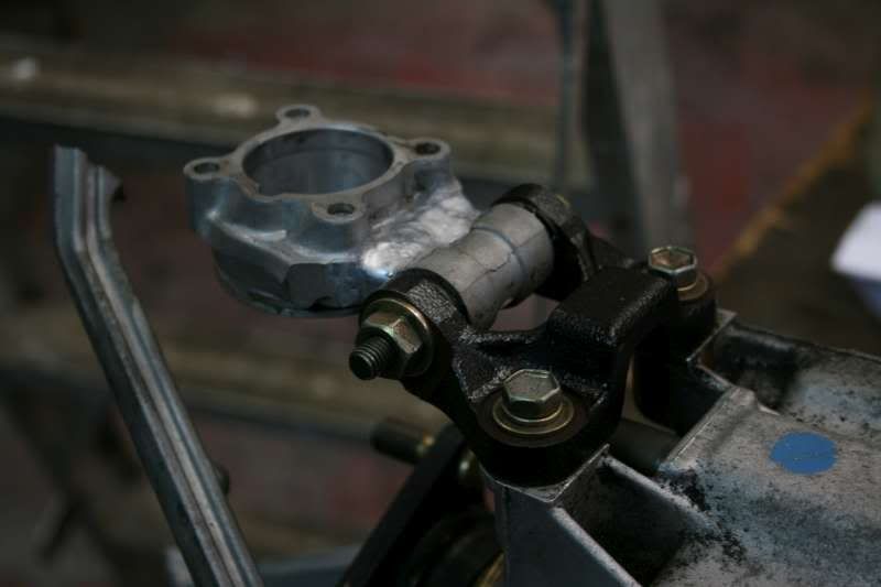

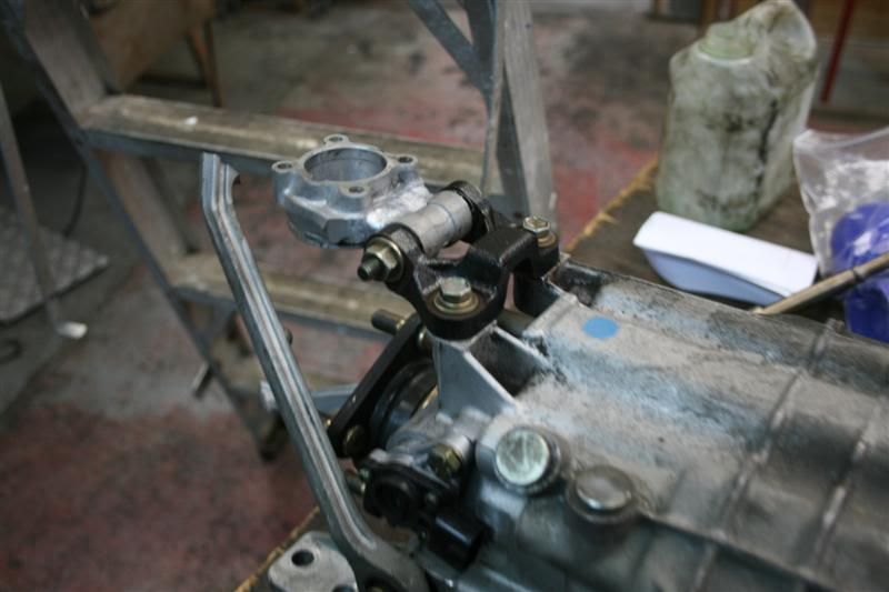

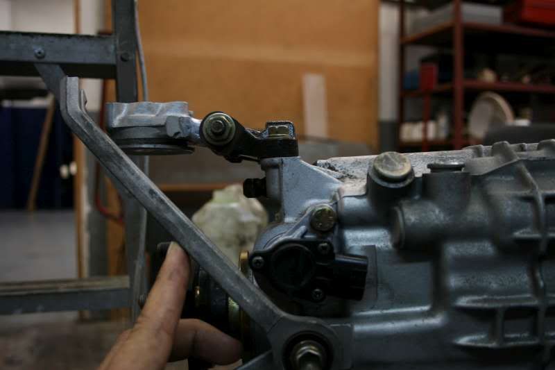

Here is the shifter finished - same as above but this time with a coat of paint :D:

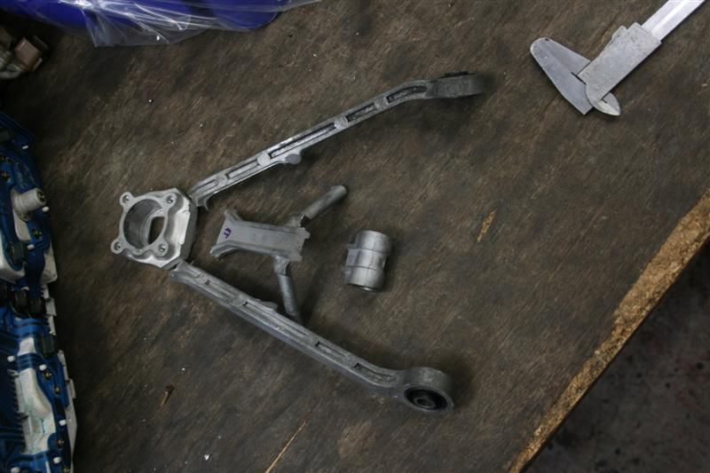

While i had the engine out i thought i had better change the rack bushes which are as old as the car and help it to go around corners :)
There are RonnieK's bushes... would like a full set but too much $$ :(

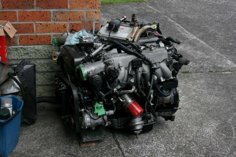

Engines on the ground.... 2JZ just waiting to go in!

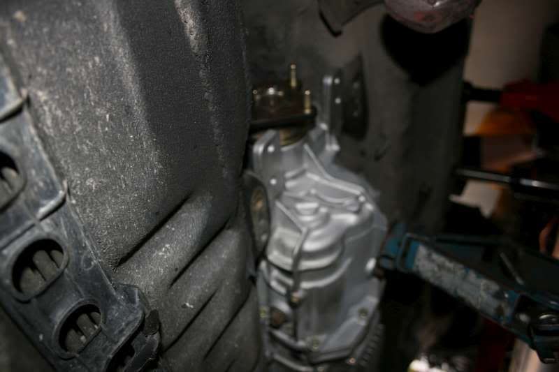

A bit too big to fit in thuuuurrrr!

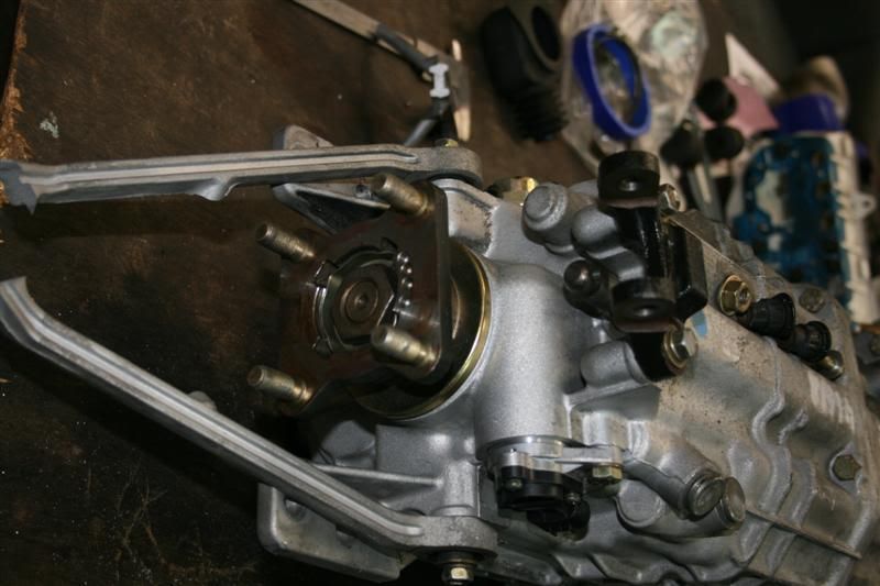

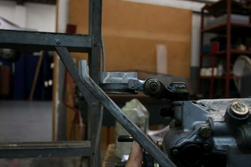

As you can see, the shifter sits back just a little (approx a inch)

Gearbox Crossmember by:
Myself and Trevor at MIT Pukekohe.
(the black one... not the galvanised flat :p)

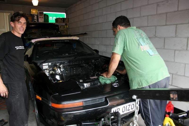

Pretty much finished!!!

I am half way (well more like a fifth) of the way through a single turbo conversion.

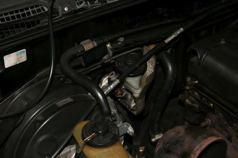

Some reasons to get this thing under way:
Fouling on clutch master:
Fouling on brake master :

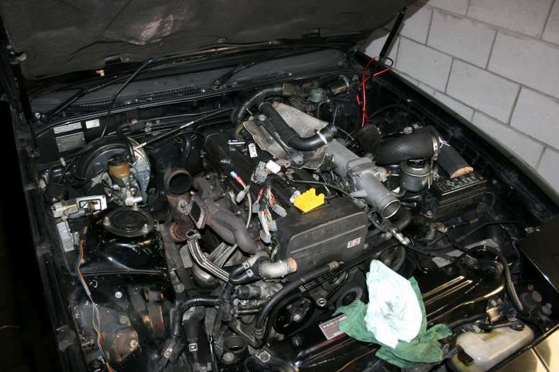

Then:
During removal:
Taadaaaaa... Gone!!
