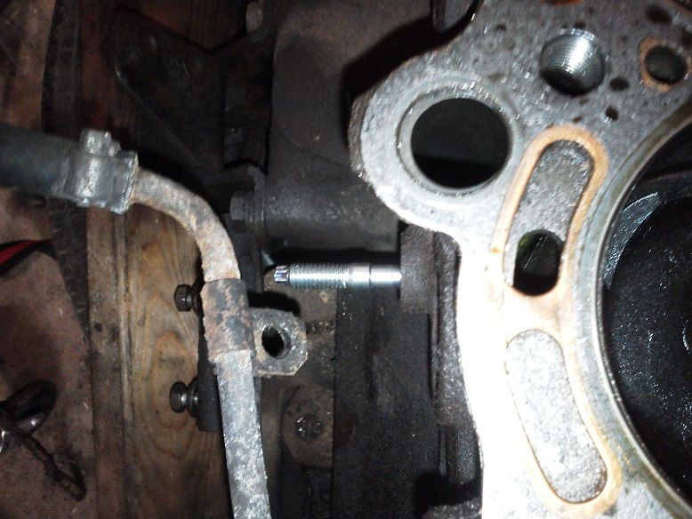

Chip: I'll order the studs today (along with some other stuff) and I'll PM you my address. I have old knock sensors lying around so I'll measure how much they both protrude and/or post pictures.

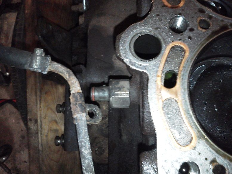

The top stud in chips picture is 2.15" long, and the bottom is 2.12" long. For a 7M, they both thread in fully and there is enough threads on the outer part of both studs to tighten a nut down on the sensor. I think I prefer the long one as the large threads sit flush with the block, the other one is recessed a little bit.
Not sure what the thread pitch is for the outer threads/nut, but I had some lying around for my water pump and rear timing cover so I found some that fit and had an integral lock washer: part # 90179-08123.
Pictures of length compared to stock sensor:
They are REAL close to being the same length, but remember: the stock knock sensor has a connector plus a wire which adds to its length. I have an '87 and am barely able to plug/unplug the stock connector from the sensor, so there's more than enough room to install both the stud and the new sensor even with the starter in place. Might be a bit annoying to get your arm below the intake manifold, but possible.
