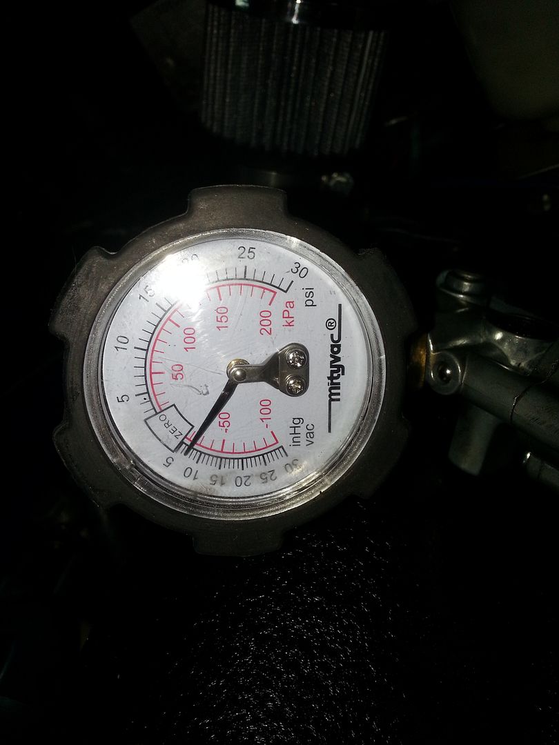

here is the photos

what is the valve type thing that you have attached to the block on the drivers side? looks like a crankcase vent?
did you build the drysump pan yourself?
hvyman
Dang Dude! No Way Man.
Authorized Seller
Joined
Apr 17, 2007
Messages
12,768
Location
Tokyo,jp
Its a vacuum regulator. its needed for dry sump systems
hvyman
Authorized Seller
Joined
Apr 17, 2007
Messages
12,768
Location
Tokyo,jp
The pump is a scavenge and pulls a vacuum on the crankcase to suck up the oil. There for you need a regulator to regulate the amount of vacuum in the crankcase.
