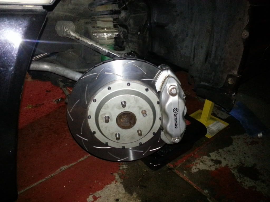

Just figured i would post this front 14" bbk setup that i pieced together all oem equipment and retains stock supra brake line and banjo bolt.and yes thats right 14 inch bbk and 17 in rim just got lucky there tho i think???? We have an enormous amount of R&D in this and it all paid off in the end now just to match the rear.

14 won't fit on 17's.
There Mercedes calipers. There bolts on.

The kit would be the complete setup, Pads, Rotors, Caliper, rotor to hub ring spacer and brackets. This is not a Mercedes caliper, and the setup is currently running on a set of 17" Cobra R replica wheels. So it does fit.

looks like SRT challenger calipers like my setup. straight bolt on no adapters.

Mercedes use the same calipers as those on most cars from the 00's. Brembos as well they just dont say it on the front.

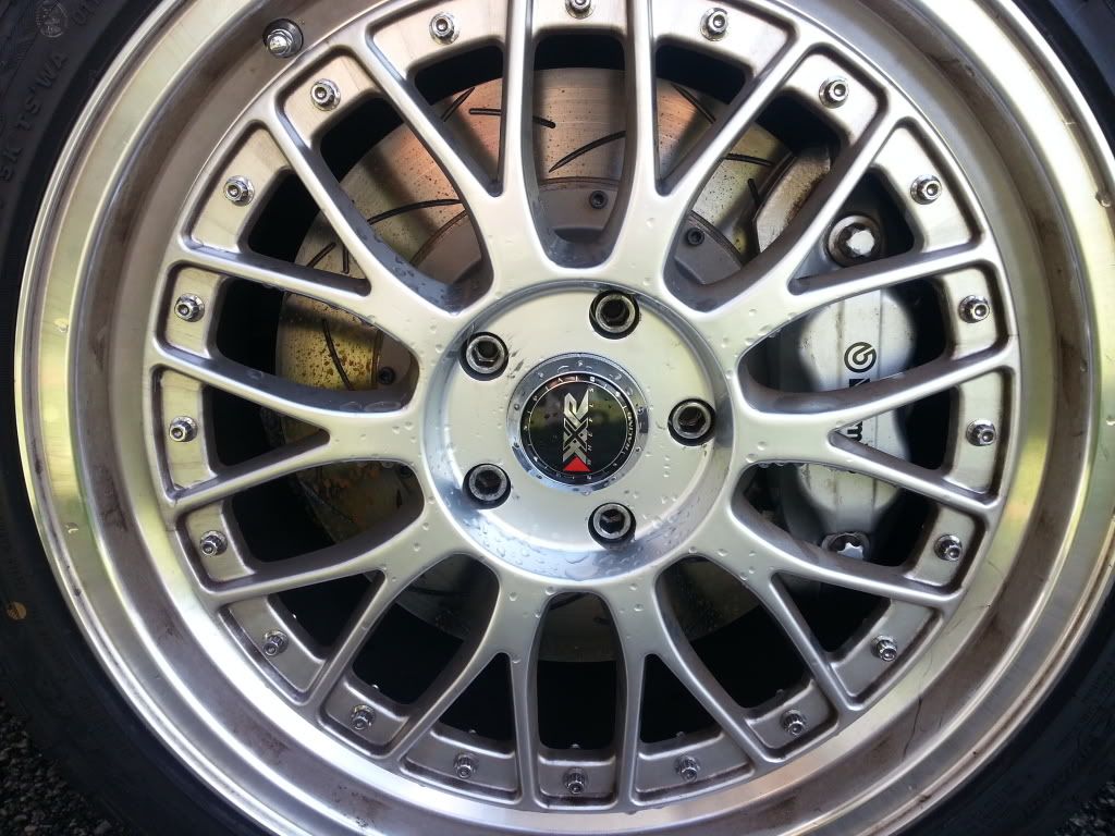

14in on a 17 wheel no all wheels are not going to fit it. Also have to be careful with the face as well. My xxr 521 will not fit either of those brakes as it hits the back of the face.

Yes the face of the wheel is a factor here but a proper offset wheel with good spacer can work wonders

Yes its a custom 2 piece rotor setup i designed with help marks engineering. Had to trim the bottom pad shield off to fit them. Now that DBA make one with greater surface area i could make a set without needing to modify the calipers. I also have the Evo/wrx rear caliper setup and it stops amazingly well and consistently at the track.
my 18" xxr521 fit great.
