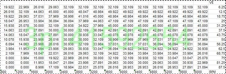

Attached is an image of the timing map. Haven't figured out how to attach files to this post. I would not use this map without a very capable knock-sense algorithm monitoring things. The stock ECU knock sensor is fast and pulls timing a lot during normal operation.
^This is the latest data. I can tell you from experience that the ECU adds approximately 11* at around 5200 rpm's regardless of boost level.

wow that's some crazy timing, I wonder what the actual timing is when running on 91.. I wish we had an easy way to log the stock computer.

The maft pro makes it easy. I'm sure I have timing data somewhere. Straight pump gas and with water/meth. I can try to dig them up if someone needs them.
you won't bee able to as that table does not take into account the knock detection scheme that it keeps track off (along with the other modifier tables). That table is essentially what happens when you disconnect the battery.
