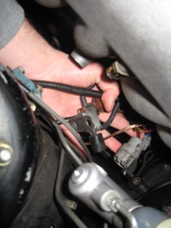

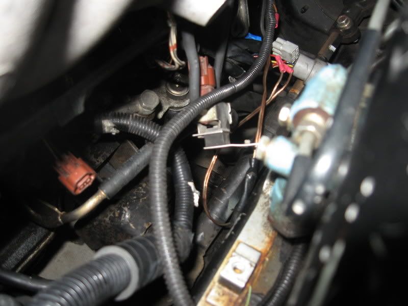

1) Ugh. Missing: fan shroud, TEMS, cruise control, EVAP cannister and EVAP BVSW.
2) The red one: VSV for the fuel pressure up system. It'll look like the one on the EGR VSV next to it. The EGR is plumbed incorrectly. It should run through the VSV shown. The way it is now will give enable EGR at all times. Not good.
3) The big grey one might be the cold start injector. It's above your thumb. The little grey one can either be ignored or is the rear ABS speed sensor in the transmisson.
4) See number 3.
5) The white one is TEMs. It's been removed on that car. The blue one is for cruise control stuff, also removed.
6) Got me there. Might be for the AC system pressure switches. They're on the hard lines that run along the fender near there.
7) Other than the crappy connections looks OK .
8) Busted wire goes to the VSV for the heater valve.
9) Nice. That's your ECU
10) You can ignore that one.
11) Look like the coolant loop (larger hose nipple) through the ISCV and TB has been deleted. Not really important.The little hose nipple is for the EVAP cannister. Emissions stuff. Your engine bay pic shows it's missing along with the vacuum valve for it. That normally connects to the front ported vacuum nipple on the TB, the little one just mentioned. The hose that's on the front nipple now belongs on the rear ported nipple for the EGR.
12) See number 2.
13) See number 6 ;)
Might have one or two wrong but hope that helps...
