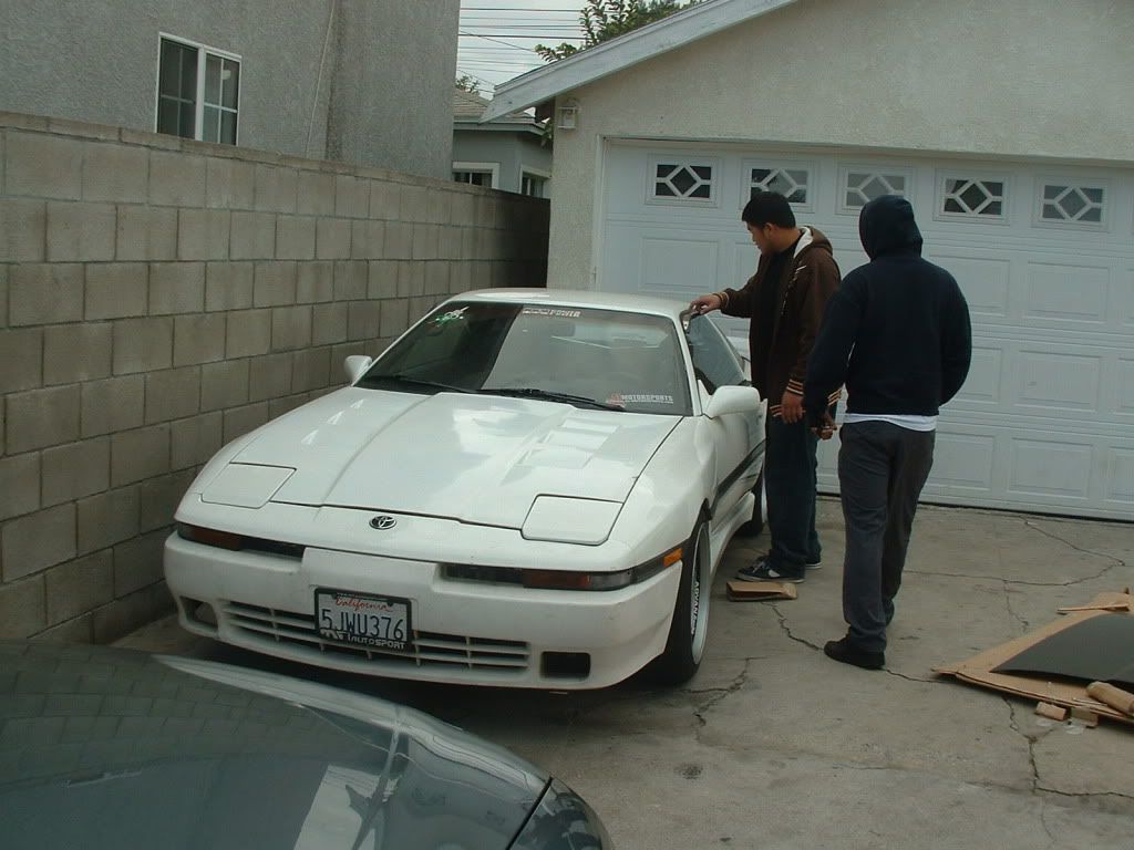

Got off work, ate some pho with my roommate, lyhor and bee before we headed off to pick up a big ass box!
After picking up the special package and loading it up. We headed over to our buddy Jsin Donut shop. It was fun chillin and your moms too funny bro! We will have a meet their dude.
Just got done taking pictures enjoy!!!!!!!

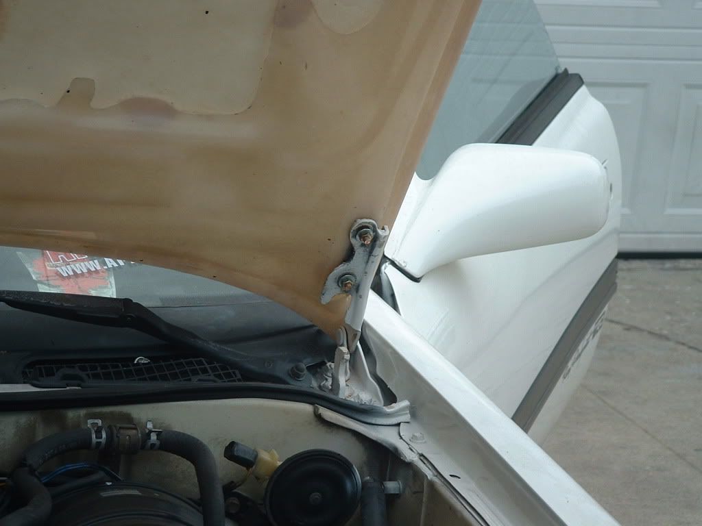

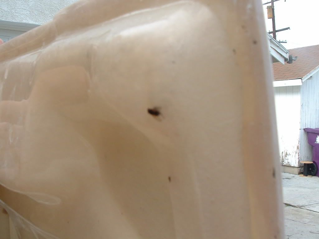

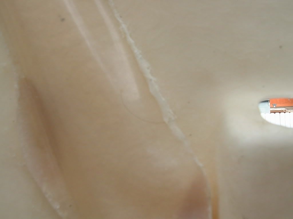

This hood is funny, and the guys who made it is funny! Theirs two JDM flies in the resin and what looks like hair dubbed "the pubic hair" by Bee. lol
Awesome fitment, lighter then my CF hood.

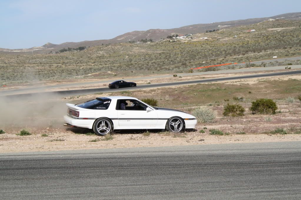

First track day I believe it was in March 2011, the 7mge ran fine all day.
The cylinder head has been "ticking" for 7yrs from a bad cylinder head repair.
I thought it got louder, so I decided to swap in the 1.5JZ
It still not quite done, it's been years since my 89 N/A looked anything like my Sig.

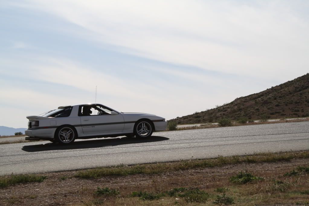

Drove the car all the way to Vegas, got caught in traffic for an hour.
I'm by myself on the 15fwy at night, hoping and praying for the best.
Engine temps reached 11 degrees Celsius on my 50mm TRD guage.
If you convert that it's about 220°F.
I may have burned the green and red color of my gauges, into my eyes staring at it for so long.
First thought that came to mind was to pass Aaron of DM in his giant motor home trailing his OMFGSOSEXYMK4.
Take a detour off the freeway and mash the gas and to get air flowing through the radiator ASAP!
At this point and time looking into my rear view mirror, with my CF wing in view.
I'm thinking to myself. "FLYLOW" and laughed to myself. hahaha
Pulled over to the first gas station to cool down and waited to link up with KillerBee who was not that far behind me.
I think this was the first time I was out of city limits to test out my electric cutouts, that added 15 more hp when opened. I flipped that toggle switch on and sat there idling while I waited for Bee.
At this time it caught the attention of a few onlookers. lol
It sounded too bad ass, I can't thank Tiwnsturbomotorsports enough for the awesome metal work and fabrication of the new downpipe. I finally have a car that looks and sounds like "BECAUSE RACER CAR" "nodding"
The BorgWarner EFR's quick spool sound mated to the engine coming out the cutouts directly under my butcheeks equaled eargasm. :eek:
Like a jet plane off I went... I'm not going to say how fast I was going.. but I did it for awhile without any issues.
I made 371hp on 17psi on my previous setup.
With the new setup she made 491hp 455tq on 20psi at sea level.
More boost more power, I'll take it.

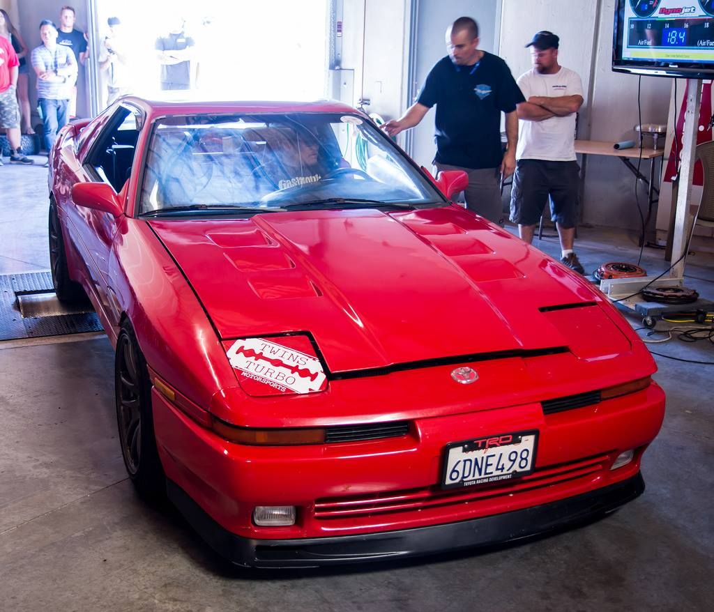

Dyno challenge:
In SIV2014 she made,
First run 487hp 431tq
2nd run 489hp 440tq
It makes 15 more hp with the QTP cutouts opened on the custom TwinsTurboMotorsports Down pipe.
Thanks for the tires Eric and Marc they came in handy at the drag race event.
BorgWarner EFR 7670 1.05 A/R is awesome on a 8.5:1 --- 1.5JZ
